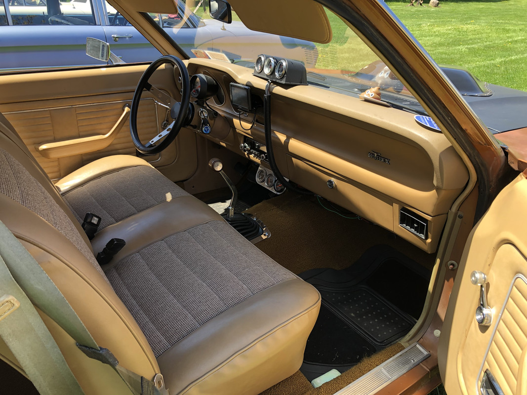

    If you are getting the vibration when you are moving and in Neutral , the Pinion Angle likely is off. Shims are available to correct or minimize angle difference and driveline vibration. As in pic' shims can only minimize vibration tendency.
    https://www.summitracing.com/search/part-type/pinion-angle-shims?SortBy=BestKeywordMatch&SortOrder=Ascending&keyword=shims+rear+axle&N=part-type:pinion-angle-shims
    When installing the T5 in the '74, seemed easier cutting tunnel for T5 and retaining original driveline angle would be simpler than attempting to match pinion angle by using shims to minimize vibrations.
    [​IMG] . [​IMG] .
    . [​IMG] . [​IMG] .[​IMG]. [​IMG]

    T5 into the Maverick 'hits' - interferes at the front of tranny and firewall. To tip the tranny low enough to not hit at front requires tilting whole eng/tranny quite significantly down. The rear output shaft of tranny is much lower than original tranny output shaft and more significantly - output shaft centerline is at a severe angle rather than just being lower.
    Would like to know how T5 swap without altering tunnel was achieved. Previous mention of lowering entire eng/tranny seems viable but difficult alternative.

    Anyone succeed with T5 install and NOT modifying tunnel and using corrective SHIMS ? - Sure seems easier ...
    did you weld in a new brace to make up for cutting the top of the tunnel brace?
    .. good question:
    Yes, cut the support brace / crossmember and welded a piece of C-Channel across, and more significantly modified the rear tranny support into a structural brace. It uses two OEM toploader support braces welded together with triangulated attachment struts for a bolt-in T5 crossmember.
    hav e fun
    [​IMG] . [​IMG]
    [​IMG] . [​IMG] . [​IMG]
    [​IMG] . [​IMG] . [​IMG] . [​IMG]
