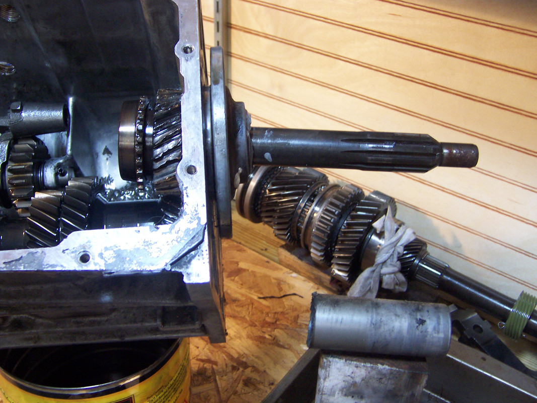

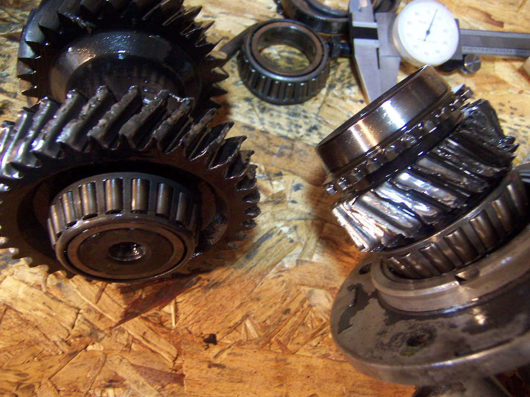

    think simple: Loose motor mount shifting engine when depressing Z-Bar ?...
    Any drivetrain abnormality will be telegraphed through your shifter. If drag-sound only happens with clutch 'pushed in' , look first to Clutch, TO bearing, then T5' front bearing retainer before internals.
    OEM- T5's are famous for the Aluminum front snout galling from TO bearing, snapping off the bearing retainer snout and wiping out input and countershafts:
    (#218 Z Spec "Pocket Bearing" T5 toast)
    I rebuilt and put in my Maverick
    have fun
