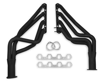

    BTW, i just looked at headers from Summit and even the 6901 Hooker's are listed for 69-73 Cougars so i doubt that the application is right. ive heard of people having a heck of a time getting the 6901's to work with a 351 in a mav
    i did find that the hedman 88660 headers fit a wide variety of app's with a 351 swap, such as: 64-73 mustang, 66-73 ranchero, 68-73 torino.....

    those are the exact headers i have my 302. they barely fit it. i doubt they would fit a 351
  3. mean_maverick
    i agree. ive run them on 3 different cars and they're VERY tight with the 302, i couldnt imagine them with a 351

    i only have maybe a 1/4 inch clearence on each side. and had to dent one for the steering box

    that might be true ,i bought mine used ,they fit great ,thats all i know the guy said they were for a 351w 70 cougar

    there is no telling. i got mine used too $10
