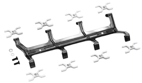

    Scott, I have a 5.0 roller cam in storage. I went with a taller profile for track only. This one has very few miles on it.
    I'm headed there today. Let me know if you want it.
    .224/.232 @.05, .510/.534 w/1.6 on 110 deg
    You're welcome to try it if you want (of course you'll need to make other changes to make your block a "roller"; new springs, lifters - which I have 10-12 of, new push rods, the spider and retainer for the lifters - not sure what else ).
    Bah. It's easier (on you and your wallet) just to go back with a non-roller setup. Good luck.

    Rick, I would love to go with the spider setup to allow a roller lifter to be used, but I am not sure if my springs can handle the .520, especially if you toss in the 1.7 ratio.

    Keep in mind that if you have a pre-1985 302 that the lifter galley would have to be drilled and tapped for the spider and that you would have to use a small base circle cam to use the stock roller lifters. Otherwise the lifters stick up to far to work properly. You could also go with the Crane link-bar lifters skipping the small base circle cam, but these run almost $450 last time I checked. If it were me, I'd stick with either a solid or hydraulic flat tappet cam and call it good. It looks like you just had premature lifter failure due to it not rotating properly. I've seen cams chew up one lobe for no apparent reason and it usually turned out to be an oiling problem or just a bad part to start with. Good luck and let us know what you end up doing.

    The spider bar and retainers kit is $55 at Scummit. A set of Holley hardened push rods are around $50 (you'd have to determine the new length required).
    The lifters that you'd need (4-6) aren't that expensive ($6.25/ea).

    I have changed my mind again. My new block has the mounting points for the spider, and I could convert to roller pretty easily now...
