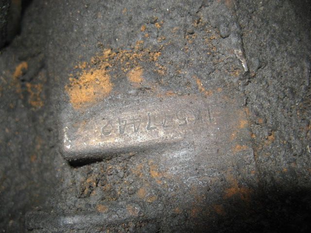

    Oh, and here's the serial number from our C4, it didn't have any ID tags on it.
    I tried looking up the number, but found no information.
