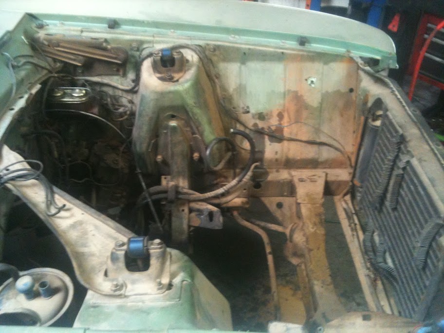

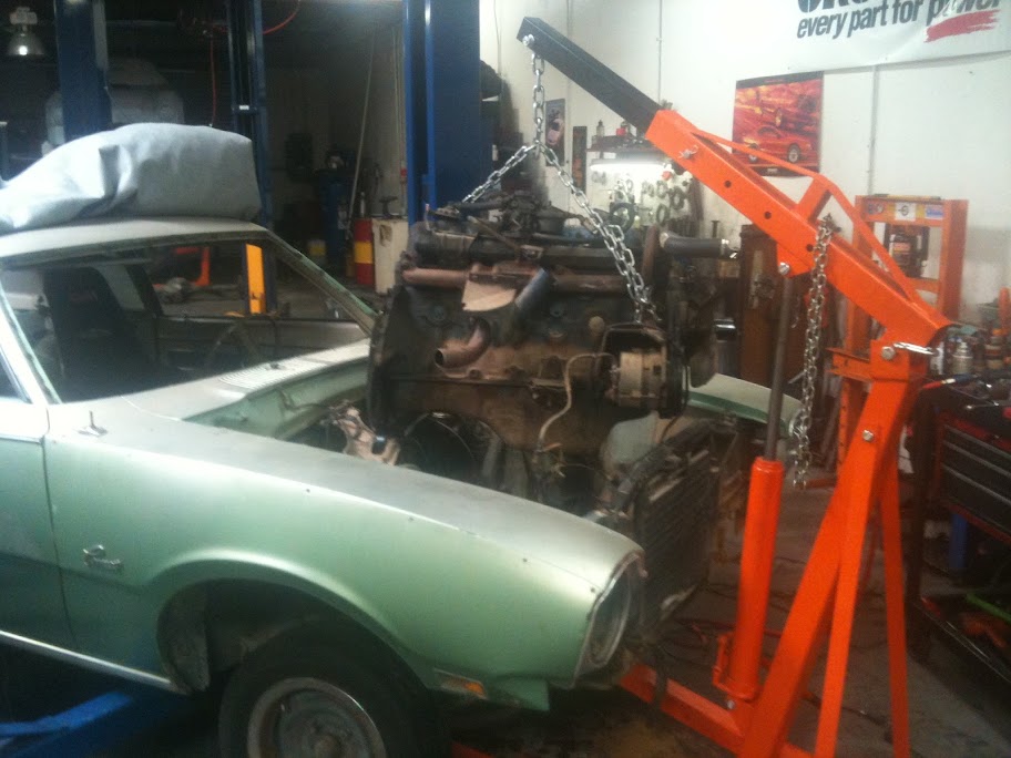

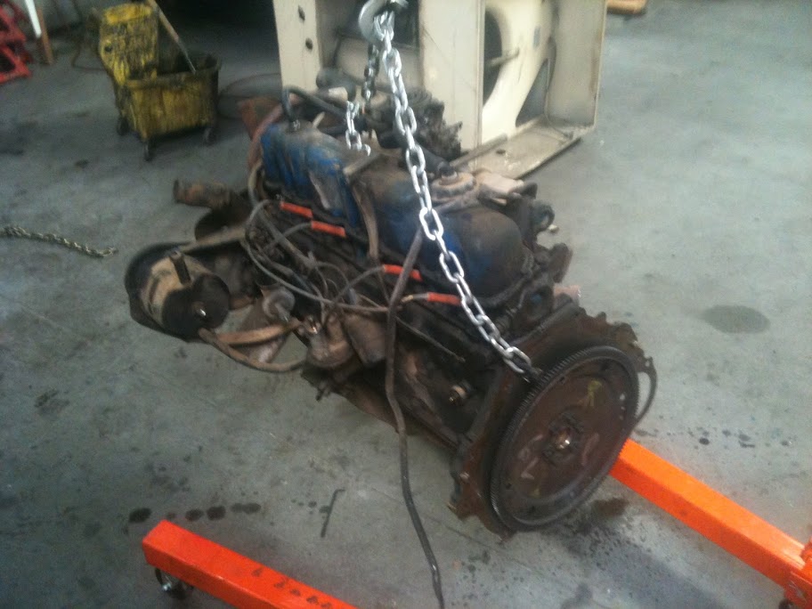

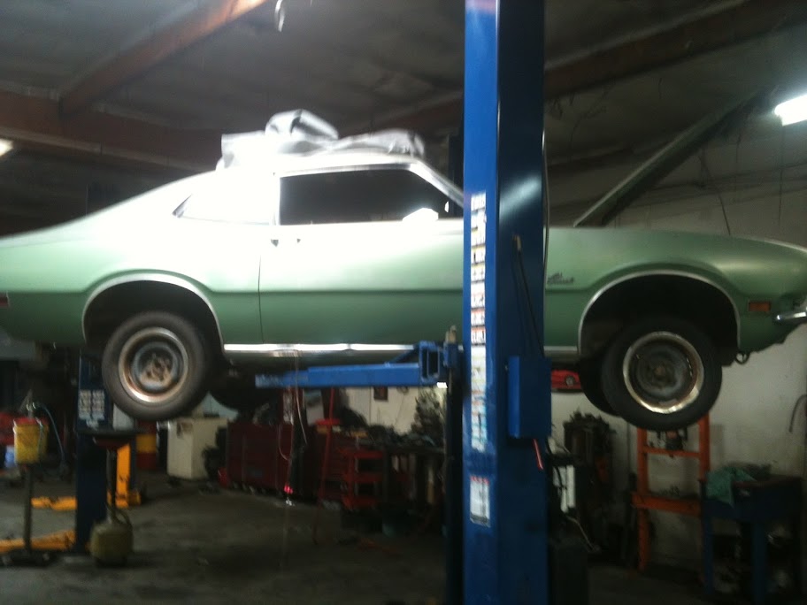

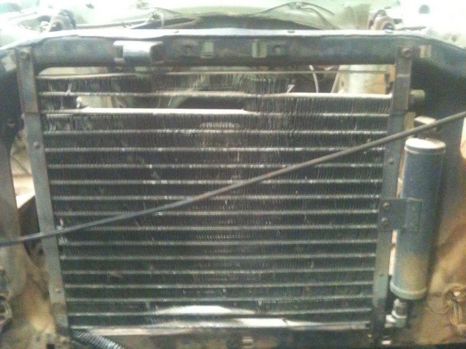

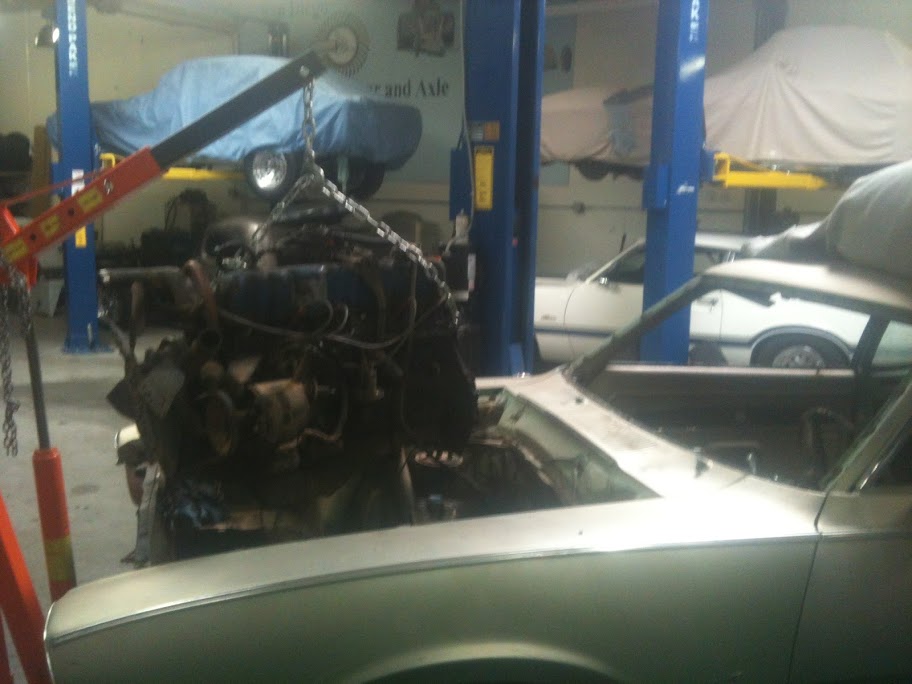

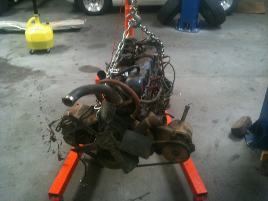

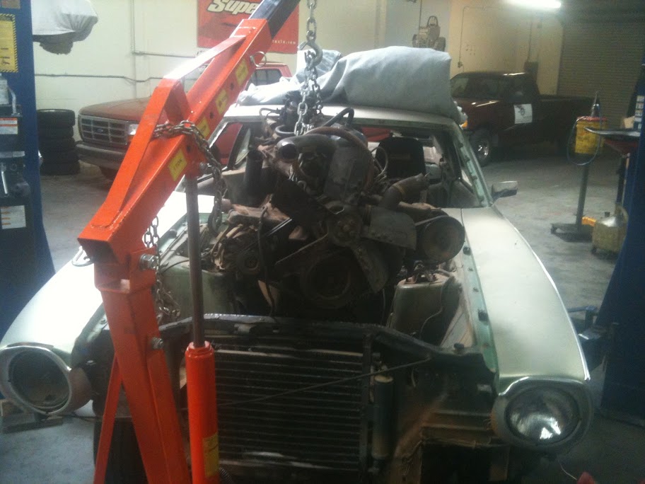

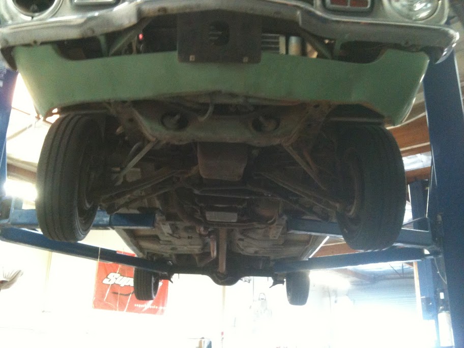

    so today i put the car up on the hoist
    and took the c4 trans out. i then pulled the I6 250 out.

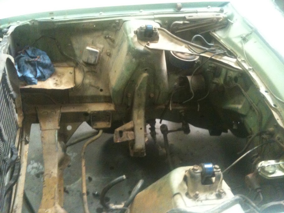

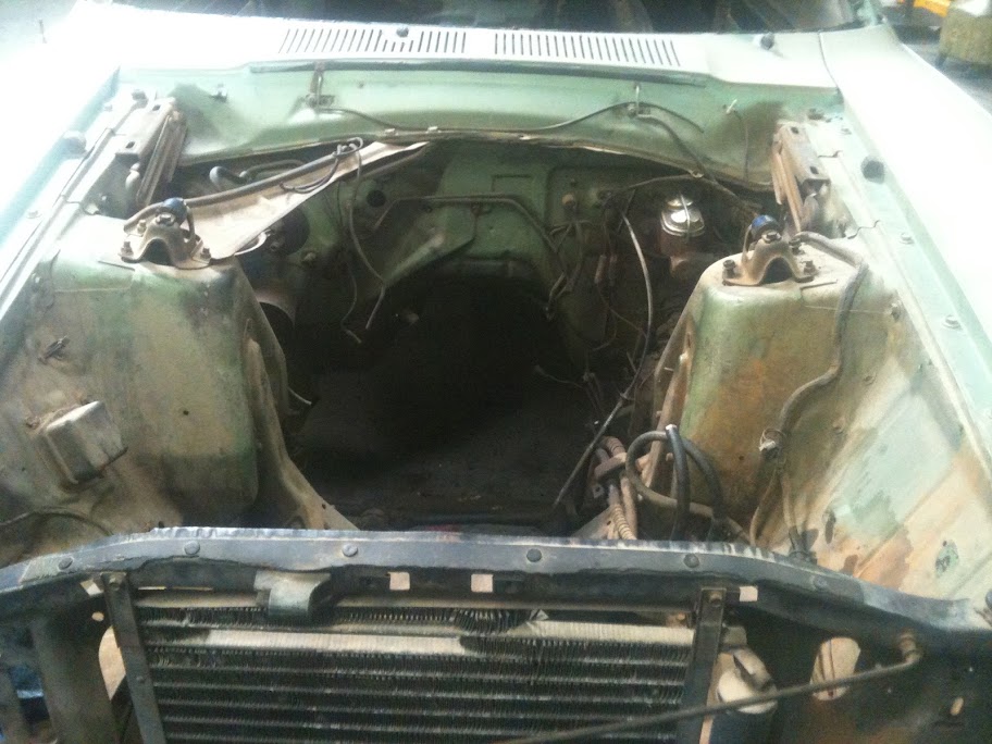

    heres the empty engine compartment. check out the awesome condition of the a/c condenser.
    the I6 is a tight fit between the fire wall and radiator support. i had to pull one of the shock tower braces off to get the motor to come out.
    im wondering if joe dirts way of using truck motor mounts on the I6 frame mounts gives any more clearance for some custom bigger tube headers. i kinda doubt it but i think i might look it to it a little bit.

    Dude, somebody took a dump on your crossmember. :D
    You say that about the motor mounts like you're keeping the six. You're not keeping it, right? :)
  10. Bryant
    im putting in a v8. joe dirt figured out that some ford truck motor mounts work with the I6 frame mounts. i noticed that the frame mounts are further forward than the v8 ones. this may create some room .

  12. Joe Dirt
    You turn them backwards and swap sides, it its it lower and further back
    You have to bolt them up to the moto first then bolt the frame stands in when you drop it in, 67-79 sbf truck mounts

    That's cool! My motor is already in but I'm curious how much lower and farther back the motor is. Is there any interference with anything by moving it? I assume a z-bar will no longer line up. Do you have any pictures of this setup with motor installed?

    The faster you go, the less condenser you'll have....
