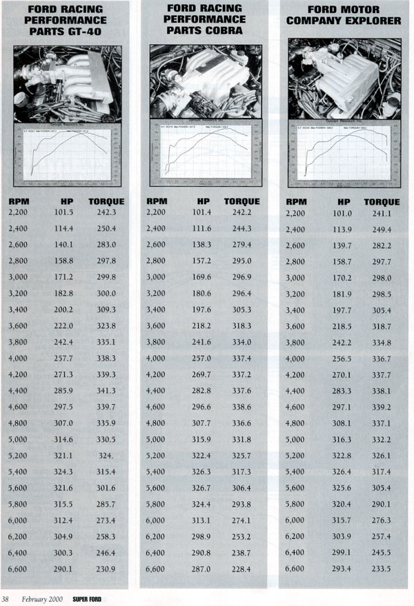

    Secondly: The Explorer intake is actually a really good move and porting it helps even more as does shortening the runners. What cam are you running in that bad boy?
    Just as a comparison this manifold flows just a tad better than the GT-40 manifold does and seems to be on par with the Cobra intake.

    Dang brutha. Sound like you've got one heckuva engine going on there. Your cam looks like has a 3200-6800 rpm range, your heads are a great choice and it will definitely help to have your compression ratio up there at 10.7:1. Honestly it may sound like your intake is indeed holding the show up some. If I can offer a friendly suggestion, it looks like this intake kit will take you to where you want to be in your cams operating range up to 6500 rpm.
    https://www.summitracing.com/parts/TFS-515B0002
