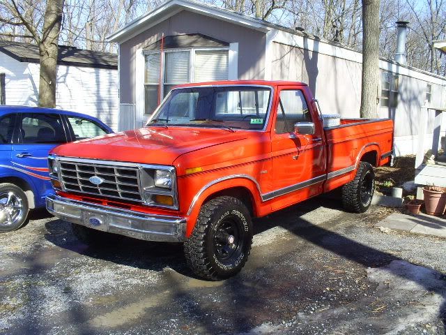

    I guess it was when I pulled a Maverick with my 86' F-150. I was not on the interstate but a few miles. I towed it backwards (cause it was just about 50 mile trip) easier than drive shaft removing and that thing was all over the place. Maybe it was just me and my inexperience at the time with pulling something, but I won't do that again. :)
    *again, I am sure it is easier/safer with the front wheels up....Ron Perrier did with no problem and I am sure I could do it better now since I have about 12 years of pulling a trailer under by belt.

    good choice, i have one as my daily driver

    it was a good truck (y)
