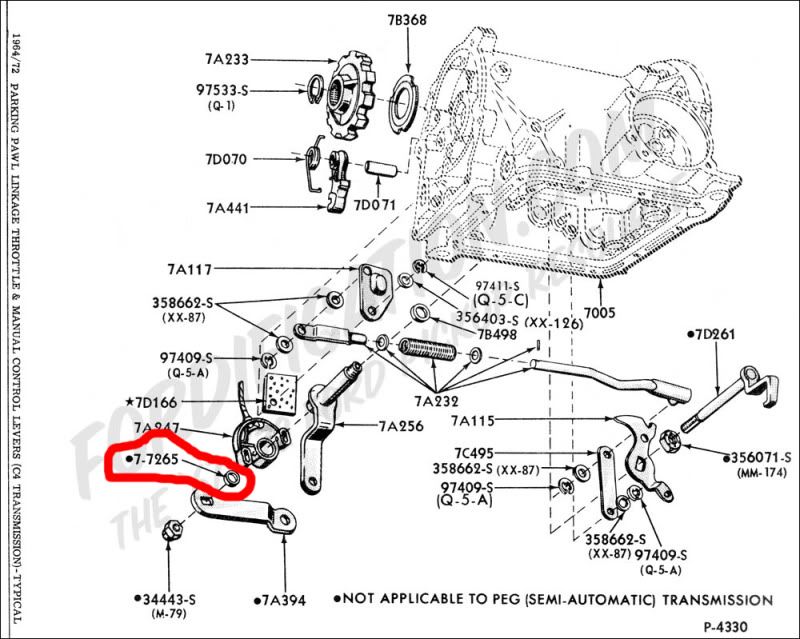

    The pan looks good. Probably after Christmas. I got the manuals in for the 73. Couldn't find anything on shift shaft seal replacement. They're Ford manuals. Anyone got a diagram?

    The 7-7265 and 7B498 is what needs to be replaced. The nut labeled 356071-S is what needs to be removed to get the shift lever out of the case. To get to it you will have to remove the valve body. That is why it would be a good time to install a shift kit as well as replacing the seal and o-ring.
  7. 71gold
    2,935
    when you go to break the nut loose, don't let the lever bottom out against the case on the inside. hold it with a wrench.

    Thanks for the advice and diagram. Helps out a lot!
