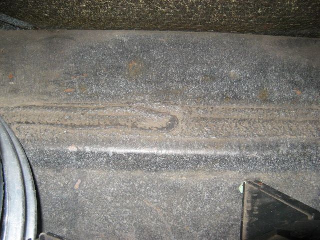

  6. Mavman72
    Trunk spatter paint...This is original...In the trunk of my 72 St Thomas built Sprint.

    Yep my car was built June and had a black engine bay.
    I did not realise the dark gray splater was so dark, thanks for the trunk pic's.
