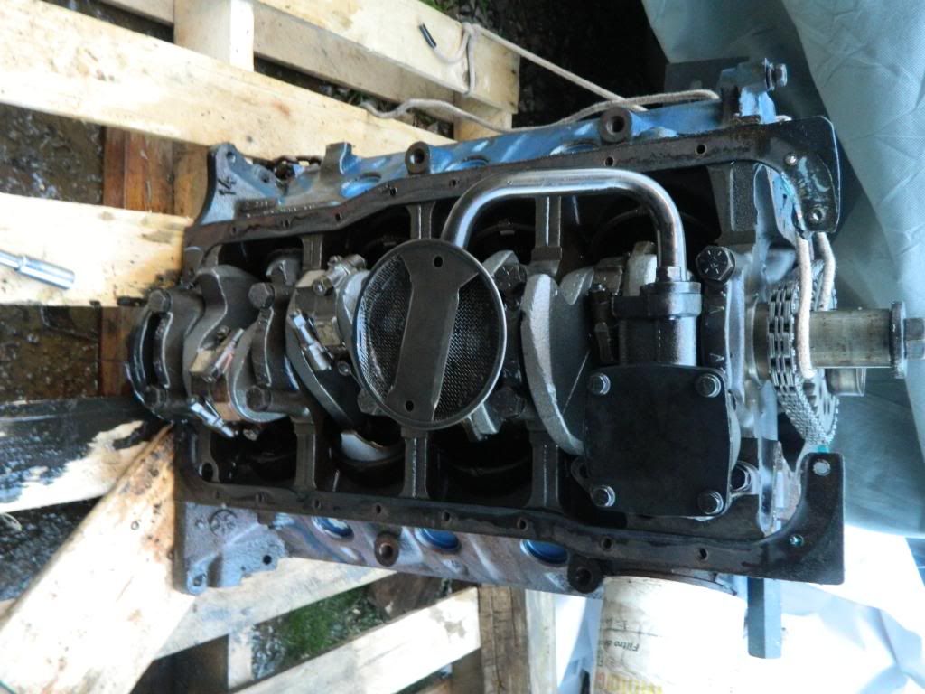

    Going back and looking at those heads again, Groberts was right. They're trashed from the sloppy grinding done on the chambers. You could start with the shortblock and replace the heads, cam and timing set (the one in that pic is not something you want to keep, the chain will stretch in no time) The only problem with going this route is breaking in and running a flat tappet cam, they've got poor track records in the past ten years for failures. So much easier to start fresh with a roller shortblock, there's zero chance for cam failures. And getting a good serviceable shortblock is easy out of the Junkyard. One that can be run as is in many cases, with only a good cleaning. Or at most just need honing, reringing and replacing the bearings on the crank. Going this route may even cost you less money in the long run than taking a chance with what you've got now.

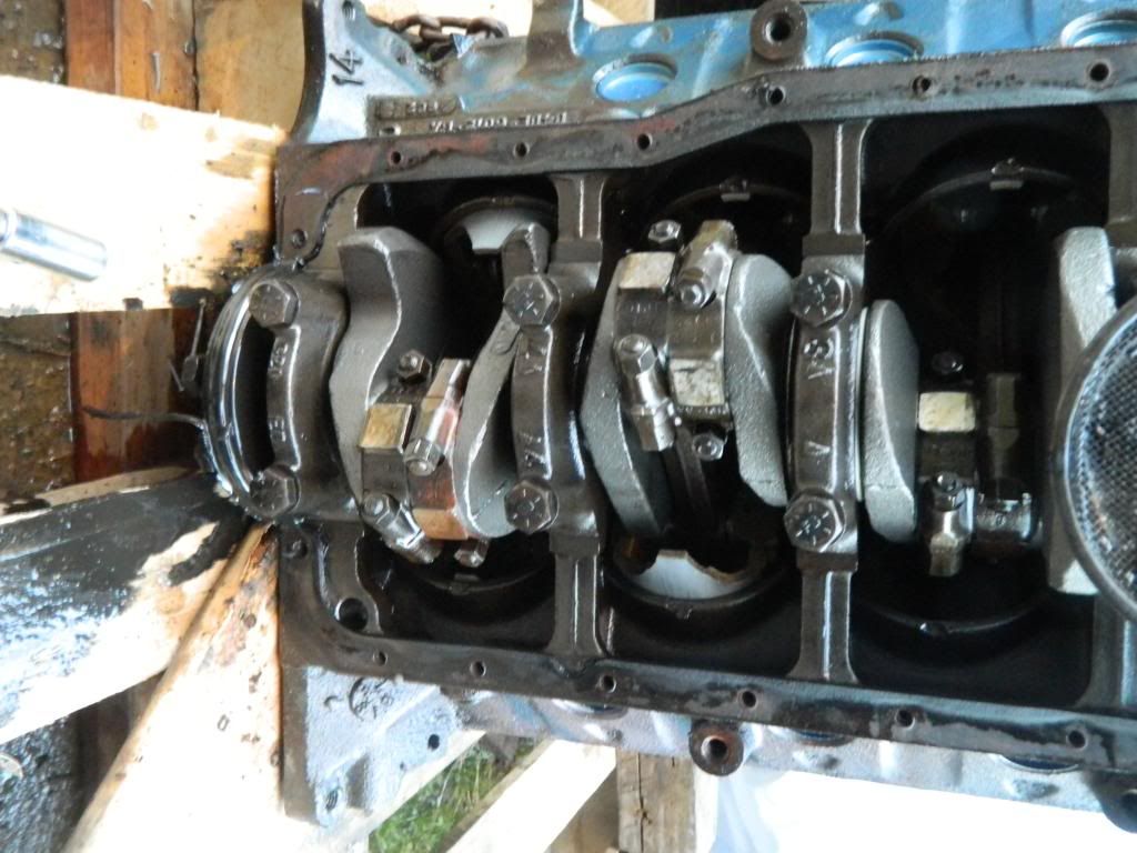

    Did you look for the oversize stampings on the piston tops ? Pretty sure the crank will have been turned as well, it looks fresh. Pull the bearing caps and see what the bearings and journals look like. Just make sure you put everything back exactly as you found it.

    I had forgotten about this pic. Maybe it could help this discussion:

    Hard to tell using a tape measure, but looks like it could be .060 over.(4-1/16") The oversize is clearly stamped into all 8 piston tops.

    Oh, yeah. That was the only pic I had of some form of measurement reference.

    They are standard. Took them out a few days ago. Says "302" on the side of them. I've also took the crank out as well. It is a 2MA and has been shaved .020 under according to the Clevite bearings. (Which were worn out)

    Strange that the crank is that clean but the bearings are worn out. Go figure. But I have run across std bore 302's that had undersized cranks from the factory. Had a .010 under come out of one I picked up last year.
