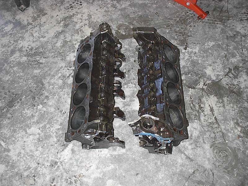

    And if you have a legit TP it's just about a blank check, name your price...
    If you're building a high RPM/HP engine, the four bolts mains won't help much on a factory block...

    Nice 2-piece block.

    lol i laughed way too hard at that :lolup:
  8. Krazy Comet
    7,793
    2,478
    I dunno if it can be saved, left side has some gouges in cylinder wall..
    Anyone have a good left half???
