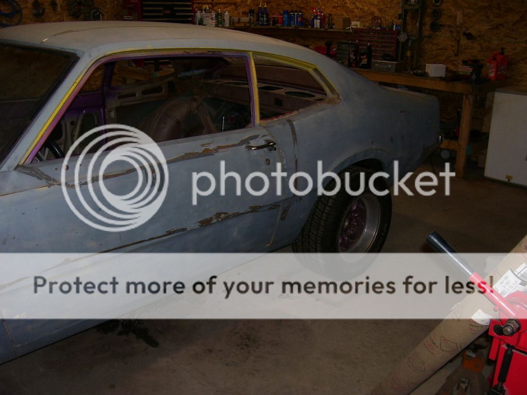

    My Mav had 295/50R15 on the back when I got it but the rearend was too wide.
    I went to 29x12.50x15 on 11" wide wheels with a custom rearend, no tubs, no spring moves.
    I think the 275 or 295 would work with the right offset wheel but it would be close.
    SPark
