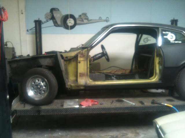

  7. Bryant
    i finally started on tearing down the maverick. mashori helped. it definitely stirred up some emotions against a volkswagen jetta and the girl driving it. i really got into pulling what i could out of the trunk and was impressed with the strength of the fuel cell. it didnt rupture or crack. it did tear through the front portion of the floor pan that it was pushed into.
    heres the only pic i took today. mo took allot more and ill put them up in my build thread when i get them.
