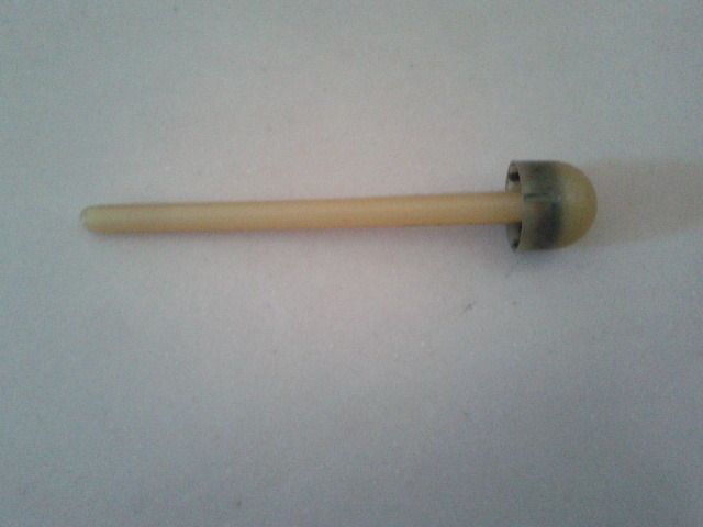

    Here is the prize I was taking about

    What is it??

    You had a mushroom growing in your transmission?
  5. darren
    Havent seen one in years. Its an assembly plug that gets knocked into the pan.

    Ding ding ding! We have a winner. I had no idea what it was either, I drain all the oil from the trans pan and hear something moving inside. At first I though I had broken something (my trans was acting up). When I first saw it I thought it was some kind of float or indicator. I had to ask a few guys and they knew exactly what it was and said to me, Your the first person to be inside that transmission. I was kind of happy but at the same time not so much because now I know this trans has never been serviced until now (new fluid, new filter, and new gasket). Now the trans shifts smooth and when it's suppose to, before I would manually shift it from 1st or D into 2nd because the engine would have to rev up so high just to make the shift but 3rd never had that problem.
