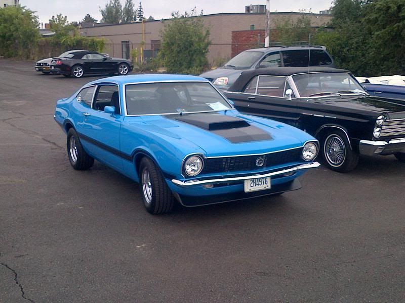

    Took my car to a all Ford show today, and another Maverick actually showed up.

    Any pictures of the other Maverick or is he a member here?????

  9. Dave B
    Yup, he's on here, from time to time
