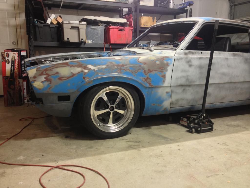

  14. 7D2 Grabber
    7D2 Grabber Member
    Apr 10, 2009
    999
    Northern CA, Bay Area
    I got my ride height set for the front left. Exactly where I wanted it
