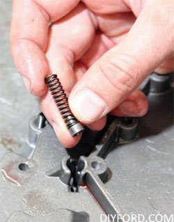

    Removed the valve body from this, upload_2022-3-26_6-15-30.jpeg to clean and inspect it. Missing 1 check ball and the drain back valve.[​IMG]
    Fortunately a trans shop that specializes in older stuff has the parts. Picking them up Monday. No wonder the trans slipped.

    Finished rebuilding the trans and hooked everything back up. Clutches were fried, due to missing valve and check ball in the valve body. When you change the filter look for this drain back valve and put it back in.
