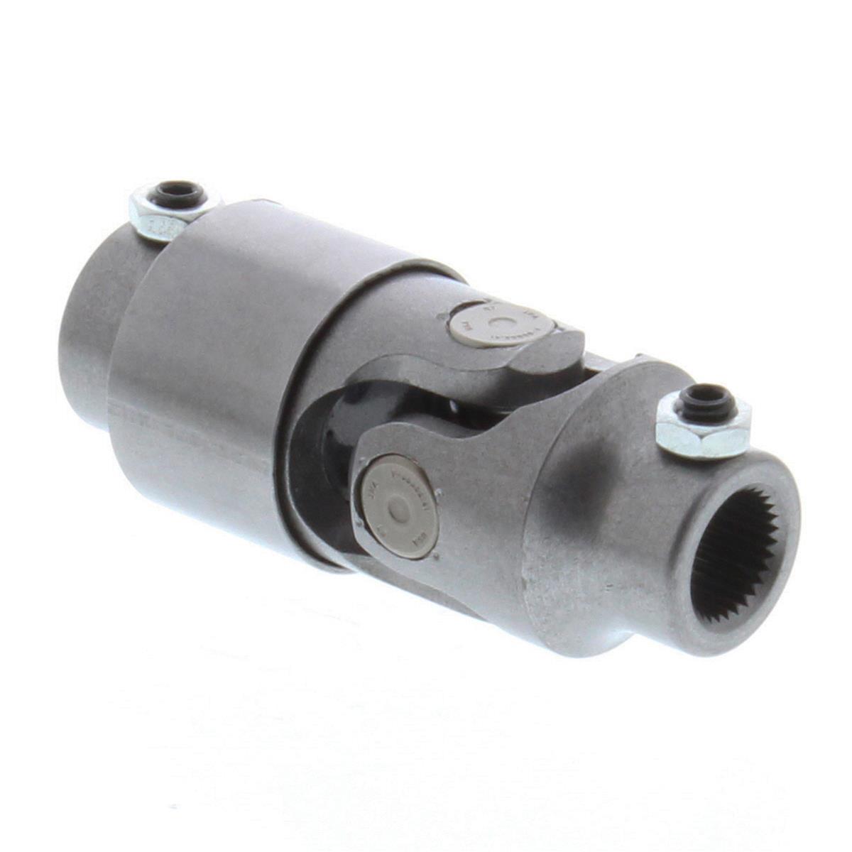

    Hi Everett:
    I was going to replace the column shift lever collar with one from floor shift that does not have the lever, so while I was at it, decide to do what member Tody did on his, see post #714
    http://mmb.maverick.to/threads/72-mercury-comet-gt-in-germany.55285/page-48
    I never did like the rag joint, so when I saw what Thomas (Tody) did, that was when I decided to do the same! Proper U-joint, 3/4" DD shaft cut, attached to upper OEM shaft in a way that will still allow it to "collapse" in case of accident and a bearing at the bottom for support.

  2. 71gold
    I used this one with the vibration dampener.[​IMG]

    Finished the steering project..........now the shaft is supported by the original upper bearing and new lower bearing. I still have my original 73 column and compared the 2 units, definitely can feel the difference between them, having the lower bearing installed much smoother. Can not wait to install in the Comet!

    Hi Everett:
    Both my 73 and 74 Comets where column shift auto's, when I had my 74, converted it to manual Toploader 4 speed, but left the column shift handle on, would always mess with people at car shows, could not figure if it was auto or manual.
    Finally when I got my 73, figured it was about time to change the auto shift column collar out, kept my steering column from my 71 Comet GT, which was 3 speed manual on the floor, so had the correct collar for the swap......
    So since I was going to change out the collar, it was also a good time to replace the rag joint with U-Joint.......
