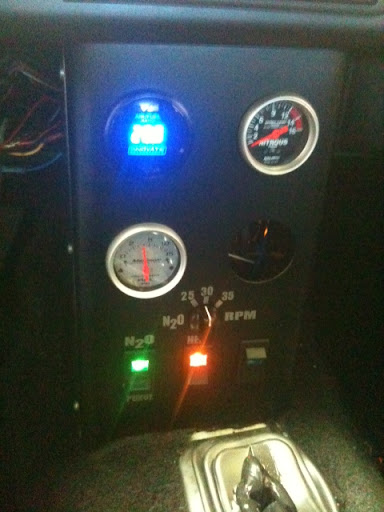

    i had my center stack for my custom dash refited to clear my shifter after the t5 conversions and just got it back toghter today.
