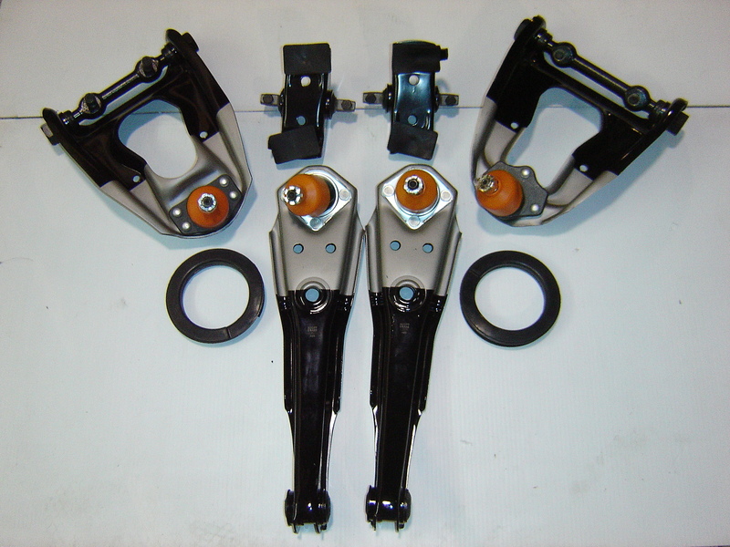

    Well, I started the front disc brake conversion. I have a 77 Maverick parts car that will be giving up its spindles, booster, brake pedal assembly, brake lines, and prop. valve. I ran into some problems of course; the old spindles were hell to take off, the worst I have encountered on these cars. I also discovered the passenger upper ball joint is finished, so I decided to order a front suspension kit from The Mustang Shop, which includes upper and lower control arms with ball joints and spring perches. The kit I ordered was for 1968-1973 mustang, so hopefully someone will chime in if I screwed that up.

    I am a little unclear what doesn't fit regarding the front wheels .... guessing it is the hub size. If that is the case, and you haven't mounted tires, most wheel companies are pretty gracious about returns. You should ask them if they have a version of the wheel with a hub size that fits. Most wheel companies have so many versions of the same wheel, it will make your head spin. See if they have one application for your car, and another listed for a 77, because the hub size did change in the run of these cars.
    Do those wheels use lugs that have a cone-shaped seat?.... or a straight shank?
  12. Krazy Comet
    7,789
    2,475
    Ford increased bearing & hub size in 1970, so your wheels probably fit the '69-earlier models...
    I wouldn't recommend machining the hub smaller but opening the wheel a little shouldn't be a issue, may want to check around on that... I've heard somewhere in the later '70s Ford started playing around with pin size for the ball joints, be a good idea to check proper fit...

    Thanks for the reply. I think I will machine the wheels, looks like a lot of meat there to work with, there is a shoulder or step on the inside of the wheel, that could be taken off, then they will fit.
    I thought they would work because they fit on a later model rear no problem. They only off the one hub size and I already have the back installed, so I'm keeping them. These cars always offer us challenges like this, making things for mustangs fit etc.
    I'm pretty sure the later model Mustang suspension parts will work, but someone might know for sure.
