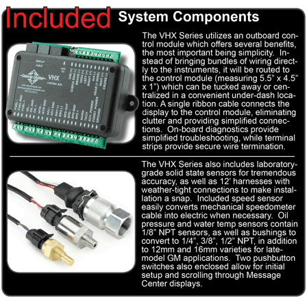

    I know a few guys that run Dakota Digital in there 57 chubbys. Great stuff, use thier wires, my friends say they are a different resistance and wont work with regular wires.

    What, they don't use copper?
  8. Bryant
    i would guess that they are shielded some how. im sure dakota digital will have instructions for what ever is necessary to properly install the gauges. i also suspect that if they do require their wire then they will include it.

    used...regular wire....on my install, no mention of...their wire...:thumbs2:

    This could have been an earlier problem. One of the guys who had this problem on a 56, said it was over 4 years ago.:huh:
    Come to think of it his cluster was not Digital it was Analog.
