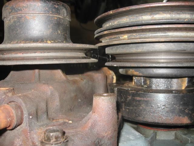

    I'm unsure of your problem but apparently you have a mismatched set of pullies...
    I installed the old pump from my Comet along with the '72 pullies on the 5.0 using it's timing cover and balancer, this is what I got... Yes it's mismatched but only because the 5.0 timing cover is approx a 1/4" thicker than the 302...
    When I installed a D2(1972) balancer I had on hand(not from Comet) I more or less got the same results...

    Ok just got back to the engine tonight..I have come upwith the following.. the motor is a 95 H/O.the water pump is from an 89. From the front of the balancer to the front of the wp is 4" so basically I have to make up 4" with pulleys. .any ideas? At this point I dont care if its serpentine or v belts..tried to use a set up froman 86 f150 with a 351. Pulleys were too big in diameter to work..id be interested in anyone giving ideas about a set up that had the correct bolt pattern

    A '86-'91 std rotation water pump will have the correct bolt pattern to use the earlier pulleys, fan, etc, the reverse rotation pumps like I pictured have a wider pattern(yeah that was new to me as well)...

    Only three bolt lower pulleys I've seen came from pre 1970 engines, all the '80s/'90s 5.0 I've seen used four...
    The Comet lower is pictured bolted to a late '80s 5.0 balancer...
