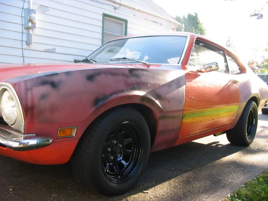

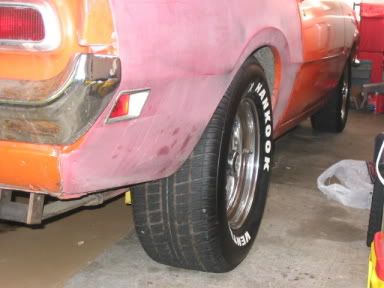

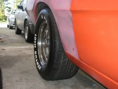

    With MY car the best BS I've found with an 8" wheel is 3 3/4.
    I've had LOTS of different size tires on the car with very little trouble. I currently have 275/70r15 on the rear for their huge diameter, but generally run a 26" tire at the track.
    I do have longer shackles that I made on the car to fit more tire, but I believe I can get away with less extension. I made them adjustable from stock length to 2" higher, just never have gotten around to playing with the height.
    Here are a few photos:
    255/70r15
    275/60r15
    275/50r15 (only one I have left. Lost a lot to computer virus a while back)
