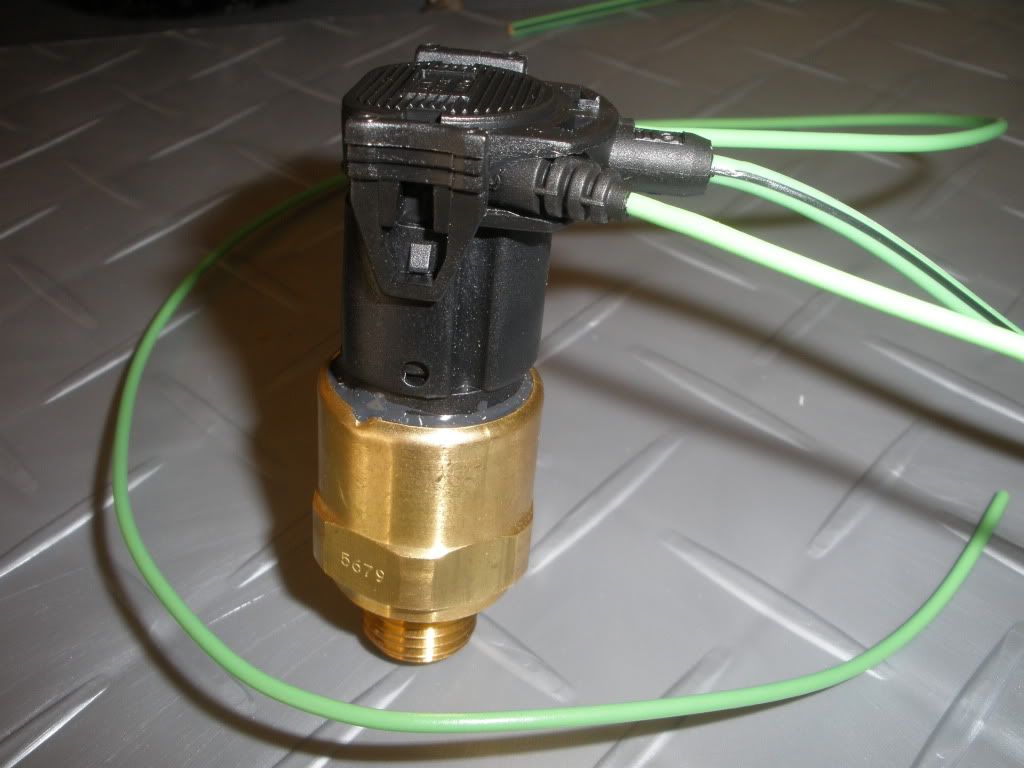

    I am running the Volvo fan and controller off a BMW temp switch (195 low, 210 high). I really like the fact the fan only runs when needed and could probably suck a small animal through radiator.

    Not sure what you mean by "proprietary BMW wiring"? From what I read it's just a 3-pin switch (high. low, and a common ground).

    You are correct on three pins. See pics, I could not think of a good way (not rigged) to attach to the temp switch pins without using the BMW wiring.

    BWM Temperature Switch Plug:
    In addition to the temperature switch, you'll need a plug to connect it to the rest of your fan wiring.
    What you'll need is:
    #61131378412--BMW 90* angle connector
    #61130007445--BMW 90* green connector wires 2 required
    #61130007446--BMW 90* green/black connector wire for ground
