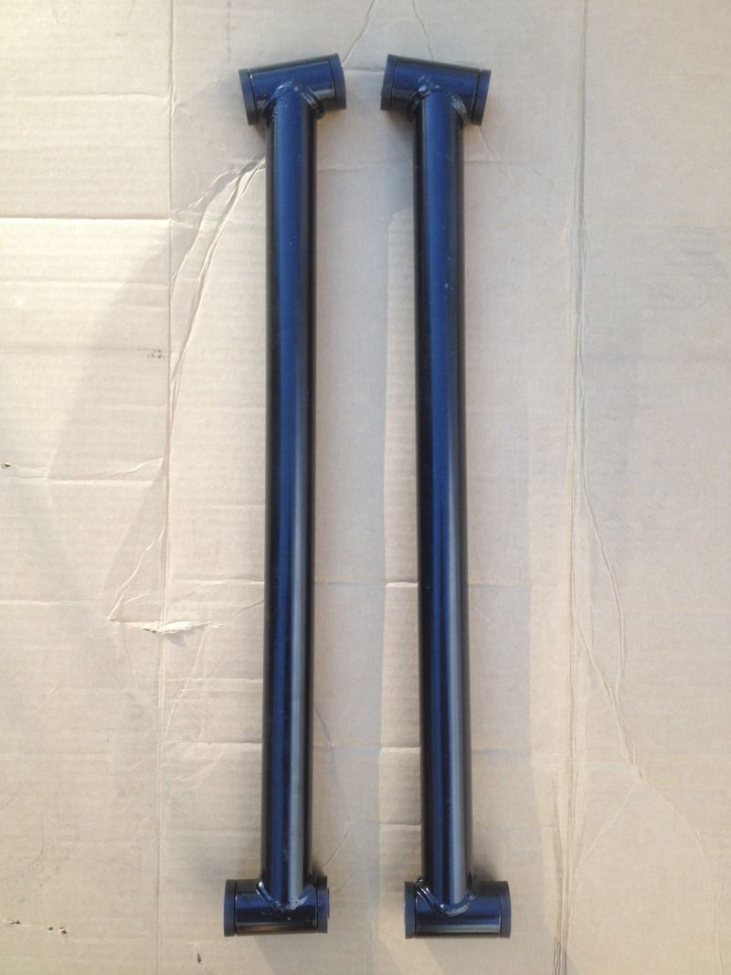

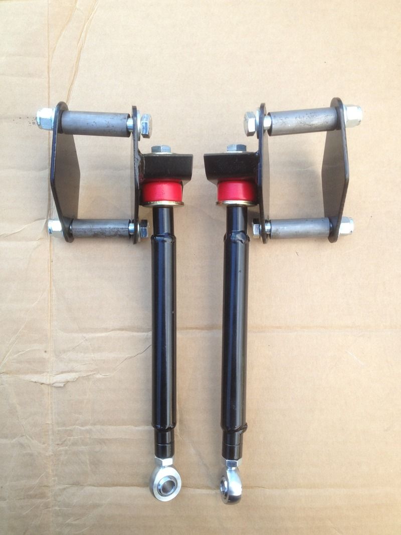

    Now the AJE lower control arms mount into the front body old leaf spring pocket.

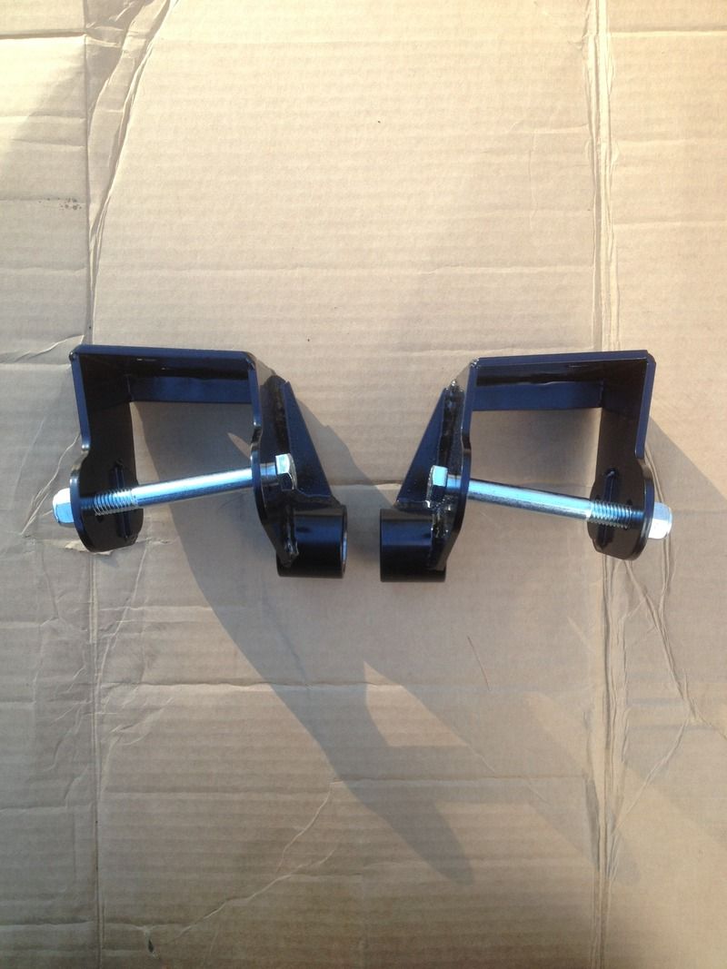

    Now the AJE control arms mount in these bolt on 8.8 lower brackets that slid into a FOX 8.8 rear end and bolt in.

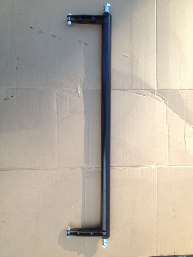

    Now the Anti Roll bar plugs right into these, No fuss ,no muss. Nice piece!
    Then the ARB mounts bolt right to frame rails. Notice poly mounts so nice on the road.

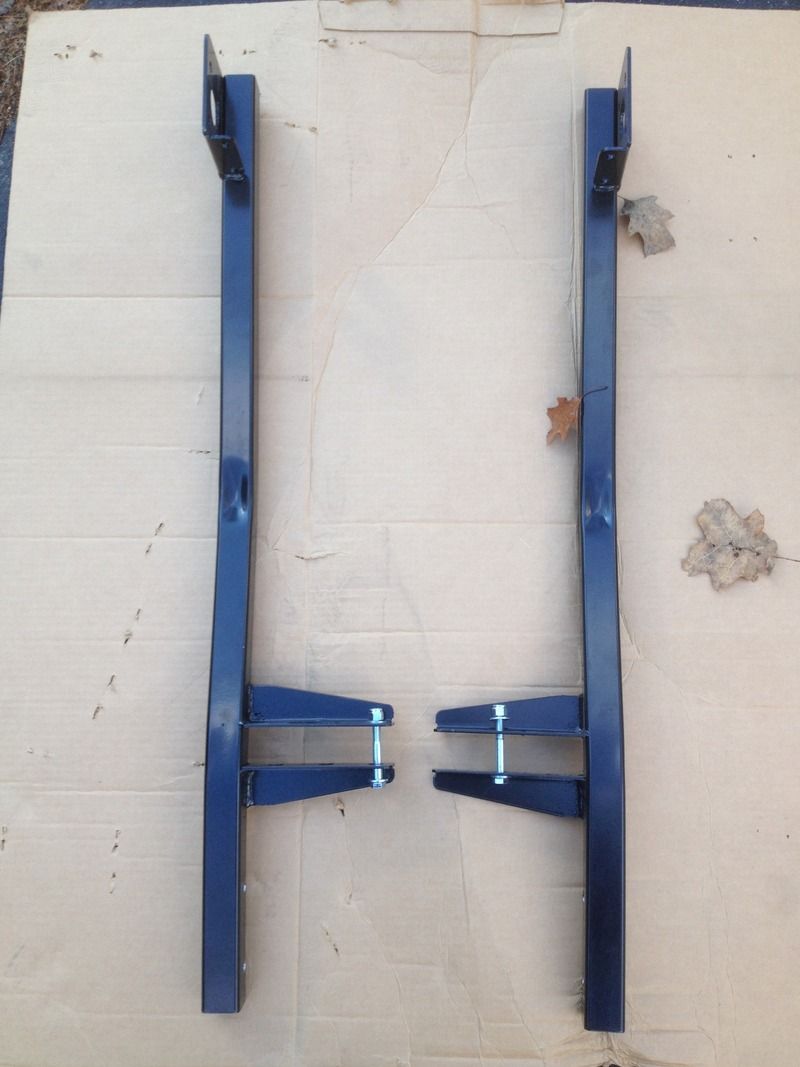

    Then you bolt in the frame connectors. You can see the mounts to hold the Torque arm front mount on the connectors.

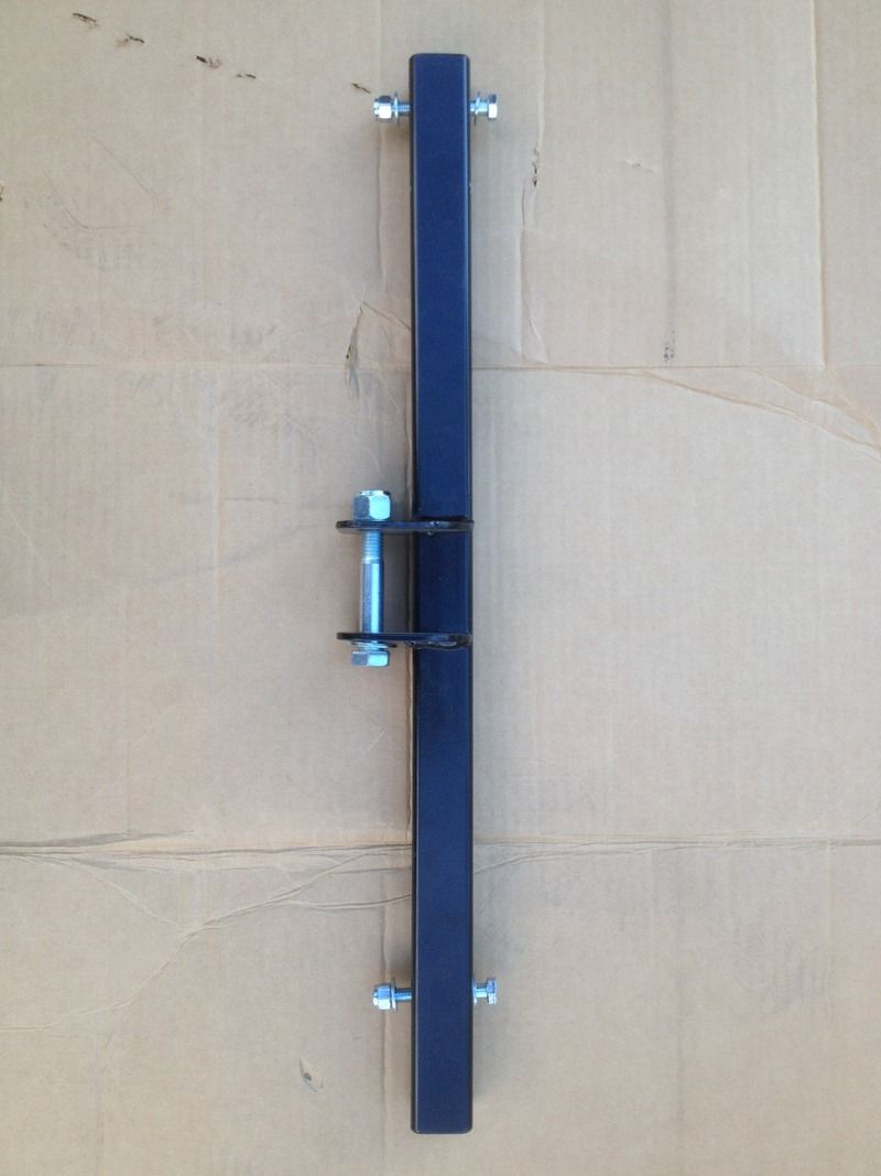

    Then this front torque arm mount crossmember bolts right to connectors.

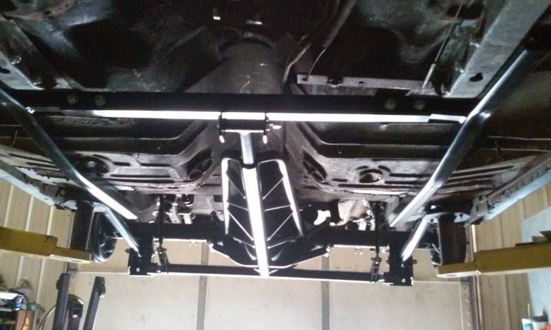

    Even with the stang II front end, it looks semi tight:

    [​IMG][/IMG] Here are shots fropm AJE with 8.8 in a Maverick[​IMG]
