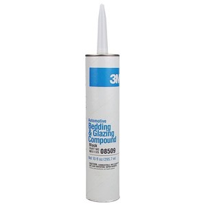

    Make sure they use the right sealer - like 3m 8509 - it is the correct gooey black stuff like the old butyl rubber sealer that was originally used for gasket glass and is now obsolete. If they use modern hardening sealer it will fail as the body flexes going down the road. I just did the front and rear glass successfully and I used a bit over 4 tubes.

    if you have to explain either one of these to them (stands/sealer), take it some place else...:yup:
