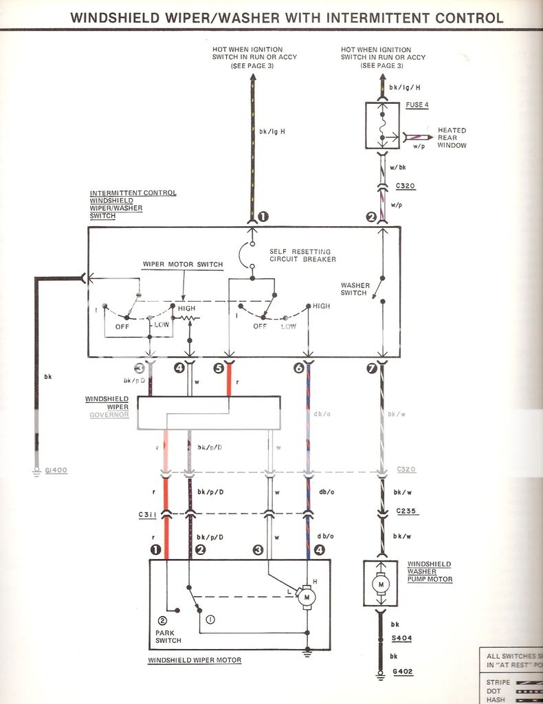

    Found this wiring diagram on Autozone's site for a '73 setup, has all the wiring but the colors (could be me) are off a bit. The supposed BLK/RED on my harness appears to be all black, I'll VOM it and verify. Should be the easiest as it's for the pump motor. From what I see, the DK BLU/ORN goes straight thru bypassing the delay box and is likely the high speed wire. I have no idea on the two "switches" in the motor (park?) or the other two wires on the motor field (WHT & YEL/RED). I'm gonna play with it in a few, any help appreciated! My motor has ground, low, high, and park...

    Which makes me wonder what exactly I have. The part number on the delay box is "D5OB 17C476- AA" followed by "260 4 L 11" and "8.7." in a circle. From my limited decoding experience, this is: D = 1970's; 5 = 1975; O = Torino (1969-76); B = Body and Electrical Product Division. Some pix here (for now). The PN on the switch looks like D2BB, which would indicate a '72 Bronco. All the diagrams I've found have either the wrong colored wires or too few wires. I VOM'ed the switch and got 11 different possible outcomes depending on switch position
    Anybody got a rear-view pic of a Maverick wiper switch? I'm thinking whatever this is, it's not gonna be a simple swap...

    Dunno if it will help but here is interval wiper circuit for a '76 Pinto...

    Well, it's got the correct number of wires, but all the wrong colors. If I only had a diagram... I did find the correct rear face diagram of the switch, in of all places, my own damned shop manual. This 5 book, 3" thick behemoth for '65 - '72 cars had about 3 pages on the wiper switch & motor, excluding any wiring diagrams! But I now have a pinout and continuity diagram for my "pin" style switch.
