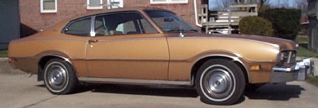

    I have a set of rocker moldings lying around. Does anyone have pictures of them mounted on the car?
    I have some used, but useable clips for them and i might have access to a 3D printer - so getting a full set is an option.
    Would you mount them? Not many people have them, but i would guess that it's the non availability of the clips holding people back?

    Maybe on a 4Dr, never on a 2Dr...

    My 70 2-door came with them. There's been some debate whether they were factory or dealer installed. I just know that I didn't install them and the original owner didn't install them. I'm the second owner.

    I've seen them on a couple of Mavericks and thought they were aftermarket.
  5. Craig Selvey
    18,345
    1,397
    Your car being a 1970 Grabber....I would say they must have been dealer installed.
    They were factory.

    I have had a few others that had them....mostly 4-doors.

    My 72 Comet 2-dr has them.

    I personally have always liked the looks of the rocker moldings. I have saved a very clean and nice set to install on my 72 should I ever obtain the clips/fasteners needed to make it happen.
    The nylon clips were of different design between the 4-door and 2-door.
    The 4-door clip attached to the rocker panel through the use of a nylon drive pin in the center of the clip which opened up on the backside of the rocker panel... the 2 door was just pop riveted to the rocker panel. The 2-door style clips were also used on certain years of Torinos, sadly these clips are not reproduced at this time, but perhaps one day???

    My 71 Comet 2 door that I had way back had them, along with the chrome trim that ran along the upper fender arches.
    I thought about possibly adding some to my current one, but not with a mid-band stripe that I am considering. Either way, I think that, visually, the rocker chrome may have an effect of making the car look higher off the ground than not having it.
    I traced the number on the clips to probably being used first on a 196os Falcon, so that may assist in finding more/repops. If I recall right, the part number should start "C8...." and that would be 1968.
