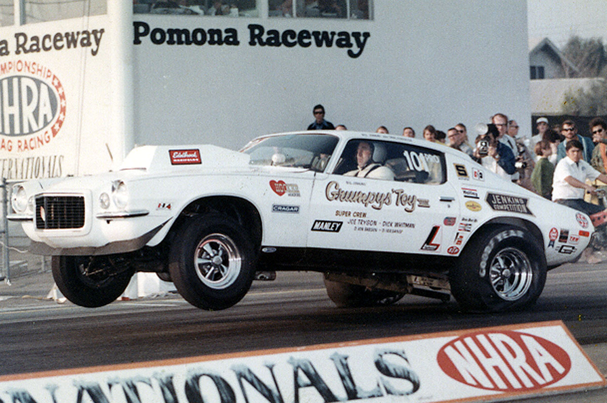

I ran 12.70s on slapper bars and slicks before I went 3 link and tubs. The basic secret to slappers is the way they're set up. You set the right snubber to 1/8", the left snubber to 3/8s-1/2" and add 2lbs air extra in the right rear. If you want to do it 100%, you add material to the bar so that the snubbers hit the front spring eye (basics of a cal-trac). You older guys (like me LOL) will remember Bill "Grumpy" Jenkins running high 10s with slappers way back in the 70s on his Camaro.
Thanks Darren,but i still think i can refine the launch alot.The car unloads the rear suspention after the initial hit on the tire.Slapper bars definately work my friend Tony's 68 Camaro has gone 10.80's with Lakewood bars.And yes his hero "The Grump"
