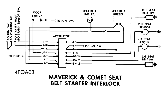

    If it looks like this...it's stuff for the seatbelt switch.

    Aha , The '74 had already had the seatbelt interlock somehow disconnected and never thought of that .
    Curious to take a look at the elec' schematic and see how the switch works within the interlock system.
    thanks

    ... so the switch senses what?, presume senses tranny in gear/not neutral ?, what happens with belts, what's the and/ or logic ?. As mentioned my 74 system is somehow disconnected - I presume.

    In the photo Jeff posted, the switch on the right is the Seat Belt Warning Sensor,..... the switch on the left for the single wire is the Trans. Spark Control.
    I assume the seat belt warning sensor just activated the buzzer once the vehicle was in gear.... I have no clue as to the function of the spark control switch.
