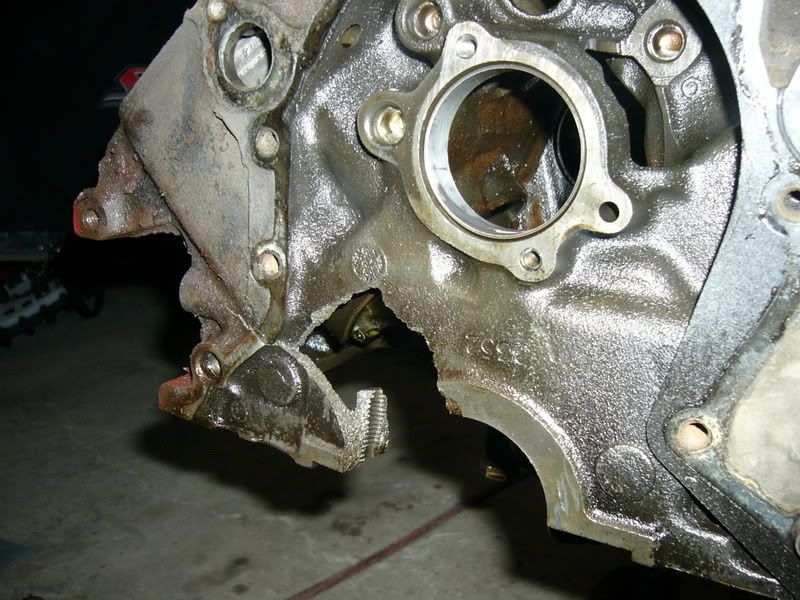

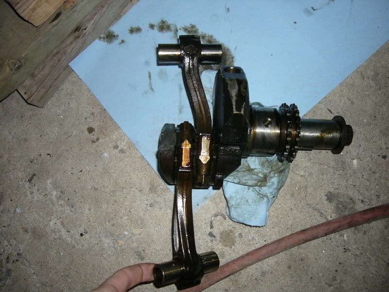

I talked to some guys on SN, and now I don't even want to start the engine. Seems to be a common malady like Jamie said. Here is an SN member failure, 94 GT: (I knew roller blocks were thin/weak, but jeez!)
OH My!!!! !! Do you know if that was a pure stock engine? Looks like it might have had a double roller timing chain, by the looks of the crank gear??
That would explain alot... Add to that thinness the fact that it has twice as much balance weight flying around the outside ring, compared to early SBFs, and that probably doesn't help. On the double chain... I don't know the answer, but I was under the impression that a double chain was standard on the HO engines.
