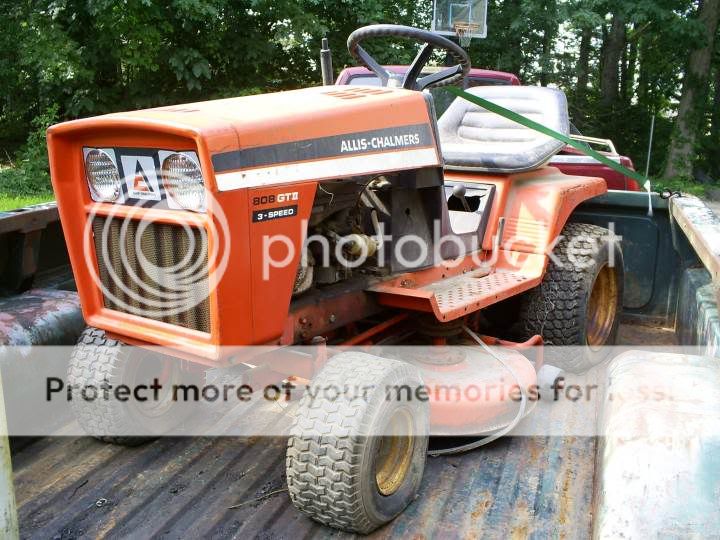

    Aside from the Camaro, we also hauled this old Allis Chalmers lawn tractor up from Terry's uncle's house yesterday. This thing has sat on the car port down there for many, many years. I brought it home and I'm going to mess with it as a little side project to see if I can breath some life back into it for Terry. It's not a Kubota, but hey, at least it's the right color. :D
    Engine appears to be an 11 horse Briggs. Date code on it decodes as 3/24/1980

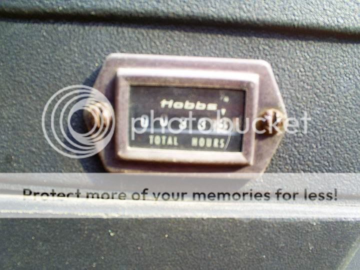

    I'm not sure if this hour meter is original or not, but there is no way this thing only has 33 hours on it.

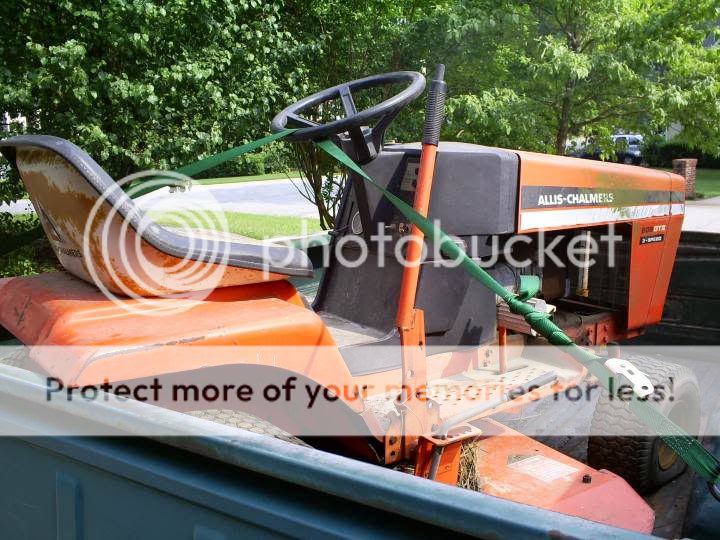

  5. Jamie Miles
    With 4 flat tires and with it in gear, a tie down strap was really all that was needed, and even that probably wasn't needed. It definitely wasn't going to go anywhere.
    I did throw a starter on it and shoot some starting fluid in it. Put some jumper cables to it and it backfired through the carb and caught fire. :rolleyes: I guess it's been sitting all these years on the intake stroke so the intake valve is stuck open. I kind of figured it had a stuck valve to begin with since there wasn't really any compression to speak of when you rolled it over by hand. Anyway, I'd have to pull the head off and probably the carb and little tappet cover off to get the valve unseized, then I would have to get new gaskets and what not. I don't think this crusty old engine is worth that kind of work when we have another perfectly good engine to go in it. I can roll the engine over by hand and see the rear wheels move, so I'm content with that. I'm going to pull the engine, gas tank and all that tomorrow and take the tractor to the car wash and pressure wash the hell out of it.

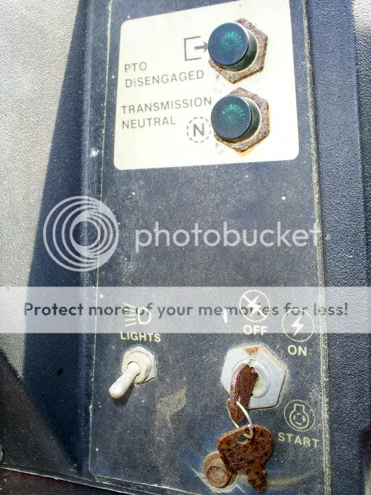

    Going to have to go through all the wiring as well. With jumper cables hooked to the battery, no lights or anything turn on, and the starter solenoid dosen't click. I figure either bad connection at the starter switch or the switch itself is bad.

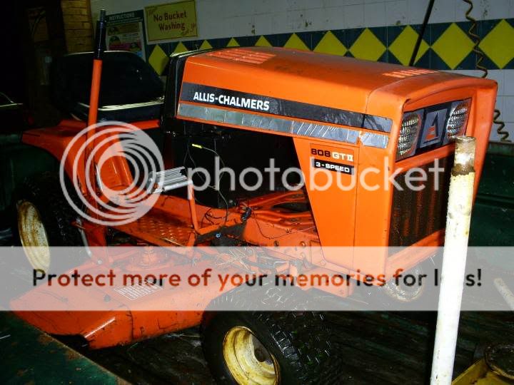

  11. Jamie Miles
    Pulled the engine, which is an 8 horse, and hauled it to the car wash. A little bit of degreaser and pressure washing later, most of the dust, grease and grime is gone.
    You should have seen the battery. :rofl2: Nothing but corrosion.
    Well, I need an engine, some tires and a battery, maybe new belts.. This is going to end up being a very good tractor.
