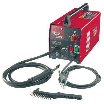

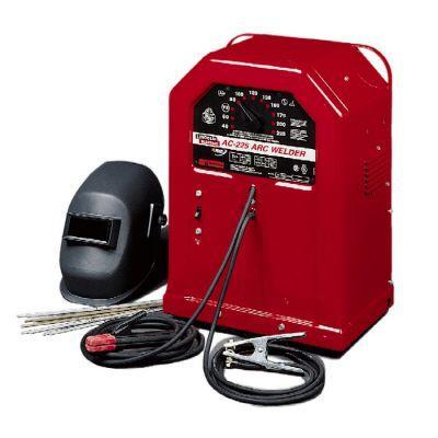

    cheapest way to go is with a stick electrode welder, if it is just for body patchwork all you need is a stick ac welder with a maximum of 90 amps. For body panels you will only run the machine at 60 amps burning 3/32 6011 electrodes. You can also use a wire feeder using flux-core wire, you will not need an argon mixture tank or regulator (mig kit). Home Depot has either one of them for $269 and all you would need is electrodes or a spool of wire and a cheap welding hood which will cost you around $20 for each.
    [​IMG] [​IMG]
    Anything thicker on a car you would run at about 90 amps on a stick welder and settings change for a mig.
