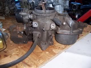

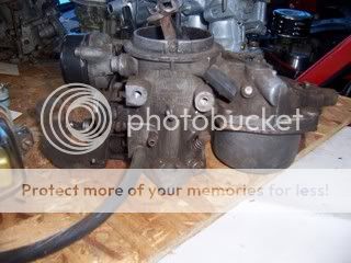

    ... presume the 250's carb is the "RBS" with low fuel bowl. Used to fit the taller decked (stroked 200) 250 small block six under the Maverick hood.
    If you really have that huge a vacuum leak to be compensated, look under the carb at the EGR return in the intake-to-manifold adapter the carb bolts to. If EGR tube or hose is broken it can result in vacuum problems...
    haev fun

    Yes, that's the carb right there! Except it was either converted to or came with a manual choke. Too bad the bowl on these isn't an easy drop like a lawn mower or something. Sure would make it simple to clean it out knowing my gas tank isn't the best of shape. I added a see-thru fuel filter but have no idea how long it ran without a filter from previous owner.
