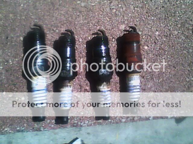

    The sticker on the engine bay said to gap them between .052 and .056 . These engines use two coil packs to fire off the plugs. The actual swap was so easy compared to a windsor. The plugs are right next to the intake and the previous person used antiseize so they came out like butter. All the ones on the drivers side were nice and tan. But on the passenger side are the issues. Number one was clean but number two was all covered in oil the threads and the electrode. I did a search and it looks like the valve seal are the first things to go in these engines. Cylinder number 3 had oily threads but the electrode was clean i suspect the o ring on the value cover is bad. And plug number four was rusty in the thread area im guessing water got into it. So now im planning a seal job on the engine. I dont know how hard it is on these overhead cam engines, first thing i need to get is the tool.
  6. maverick75
    9,014
    Here are the plugs. Number one was the clean one. Number two was oily all over. Number 3 was oily only on the threads, also the electrode was wet and smelled like raw fuel. And number four was the rusty one. [​IMG]
