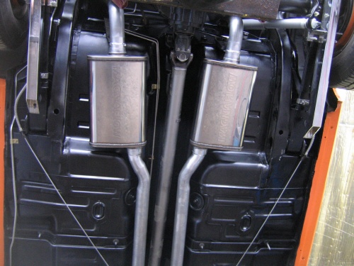

    Find a better exhaust shop. :yup:

    Going over the rear axle, mine go outboard of the frame rails. It gets tight around the shocks, but can be done.

    I sense some interesting bends in the exhaust pipe as it goes by the shocks. Would you happen to have any other shots of it? Thanks.

    Why after you spent time centering your tank would you put truck tailpipes that exit right behind the tires ? When you made room to go all the way out the back then didn't even use it.

    These are the only other shots I have.

    Passenger side pipe of my 73. Previous owner did put a mustang tank in it.

    I think I'm getting claustrophobic! lol
    Pictures like these sure make me glad that I don't mind cutting, grinding, and welding to make things fit a little better.
