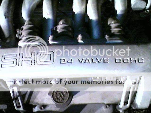

    As for the engine, I got basically the entire dash harness, engine harness w/ the computer, the steering column with SHO steering wheel and key still in the ignition, gauge cluster, fuel tank, MAF meter with the rubber intake tube and plastic air filter box, and the radiator with the Taurus fan that fits the Maverick radiator attached! :thumbs2: The seller worked at a salvage yard, and the car it came out of had been sitting in the salvage yard for about 12 years. He pulled the engine out of the car before they crushed it, he was planning to put it in a '65 fastback Mustang, but ended up selling the Mustang.
    The engine also appears to use the exact same mounting points as the 3.0 V6 that I had test fitted in my '73 last year. Here is a pic of one of the 200 I6 mounts bolted to the 3.0 Vulcan V6, the SHO engine has this exact same spot I could bolt a mount up at:
    Unfortunately though, the oil pan is rear sump on the SHO engine. I'll have to pull the oil pan off and take a look at the oil pump and see if anything can be done about that. It almost looks like the engine would drop right in between the shock towers, or at least with a minor tower shave it might. Next weekend I'm going to get the EFI powered up and test run the engine sitting there on the ground, then I'll pull the manifolds off and test fit it in my '73.
    Here are some crappy night time cell phone pics of the engine, it's a little dusty from sitting on his car port:
