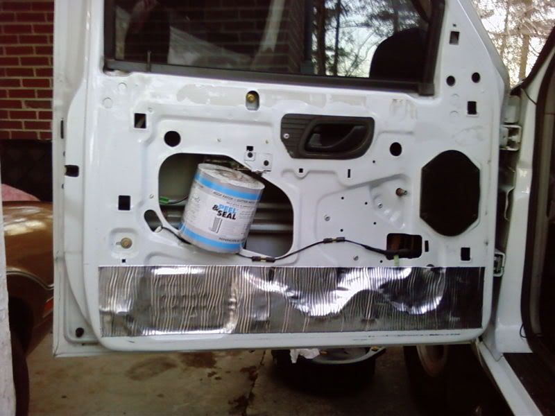

    Okay, not a Maverick, (the maverick is in the far left of the pic though) but here is a shot of the Peal n Seal install on my truck. Same principal applys to the Maverick.

    Bed liner brushed inside the door skin and inner webbing (away from moving parts) will add mass to the metal and reduce any reverberant sounds. Or if you hit the lottery last night Lizard Skin. http://www.lizardskin.com
