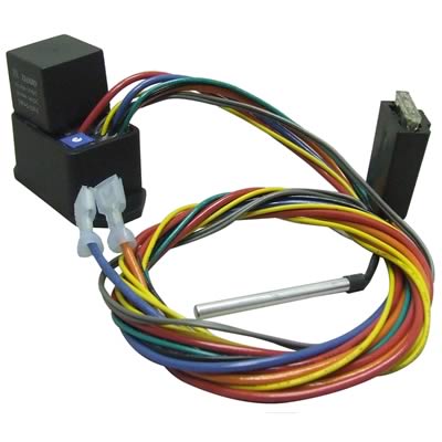

    Right now I have two fans running off of a adjustable temp controller. The kit is very similar to this picture. [​IMG]

    So, it would seem the copper tubing sensor would have to completely replace your current controller.
    The copper setup should simply close the contacts at a given adjustable temperature. (would have to see the specs on the copper tubing controller). That closing action could energize the coil side of your fan relay, which would turn the fans on.
    Could be that the only thing wrong with your setup is that the relay went bad. What two fans are you using? Do they exceed the current rating for the relay?
