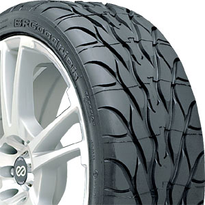

These tires any good? Anyone have any experience with them? BFG g-Force T/A KDW NT

    Actually for the wife's mustang, but I figure they would be just as good (or bad) on a Mav or Comet.

    We put them on a lot of the Atlanta area Marauder guys cars until they quit making them in their size. They loved them. Good grip and not too noisy. Cool looking tread pattern too. I think they said they were pretty good in the rain as well.

    These are described as being sticky, quiet, and good in rain. So I am willing to spend a little extra for her safety, if they are actually that good.
  4. scooper77515
    Yeah, cool pattern, too. Looks kinda like flame-age!!! :thumbs2:

    My dad had those on his Mustang until he sold it. He liked them and had no complaints. He felt they were much stickier than the Pirellis that came on the car. Plus, they look cool
  6. darren
    Looking at that tread design I would think they would be very sensitive to shock condition and rotates. The blocky outer tread looks like it will scallop easily and end up real noisy. Just my opinion.

    Guy at tire shop said that they are in fact sensitive to rotations. But that is fine, I rotate religiously.
    In fact, will most likely rotate these every 2000 miles. That is all the wife drives every 6 months, so I am swapping oil on a 6-month rotation, rather than 5000 miles.

    OK, got them on today. Very aggressive looking tread, and makes the car look a bit more beefy.
    Since we bought the car used, in 07 (it is an 05 model), the rear end has had a wavering roar, and we worried about it. Took it in for an inspection before we bought it, and Ford guy said tires were wearing odd, poor rotating from previous owner.
    Then when we bought these rims off craigslist, there were a set of Geforce tires on them, the older models, with regular-looking tread. But they also had 35k miles on them. We hoped the rear end sound would go away, but it didn't, so we continued to worry about it.
    Well, today, new tires, and that rear end noise is gone. So apparently , it really was poorly worn tires all along.

    Doesnt surprise me. After this many years lookin at tires you get an eye for which ones are going to have scalloping issues or be sensitive to it. The biggest factor is suspension condition and that translates directly into rotates as well. Still some tire designs are prone to it. The key is to have the outer tread bar tied together. This is a huge help. Keep up on those rotates Scoop or that rear end noise will be back. Good news you know its not the diff.:thumbs2:

    So you mean the scallops come from those outside tread "knobbies" not being connected together?
    Hmmm. I didn't know that.
    The noise wasn't that bad, just worriesome. If it comes back, I wouldn't worry about it KNOWING that it is just the tires, and not the differential.
