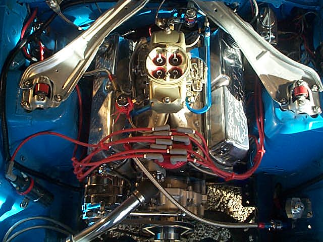

  7. CometGT1974
    CometGT1974 Gearhead
    1,583
    Western NC
    74 Comet GT
    If you decide that you want to go aftermarket here is what I am using....the cable is made by Lokar and the bracket is made by CSI.
