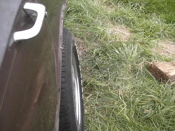

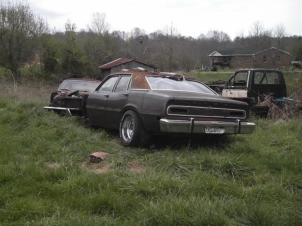

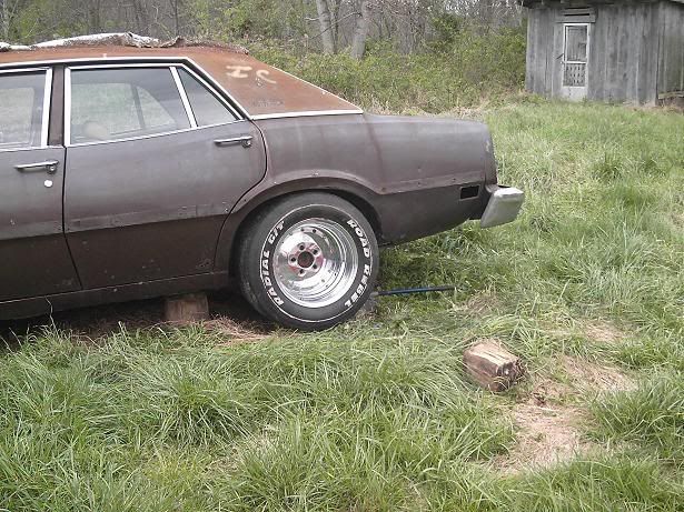

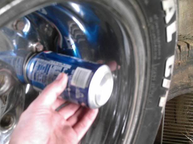

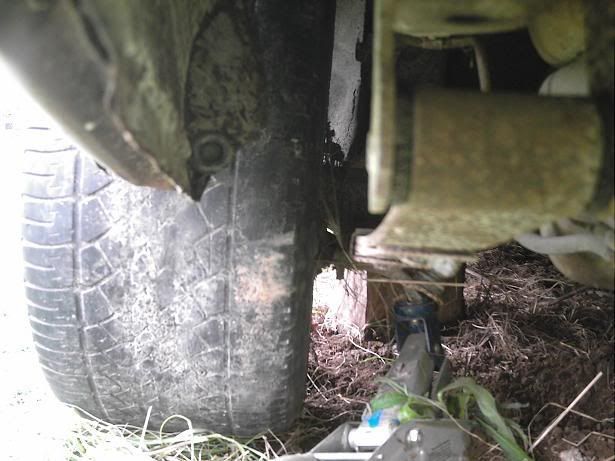

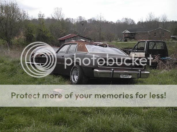

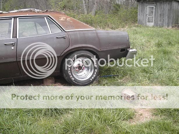

    Well 10's will fit but they do stick out a little. I test fitted some Cragar SST's on one of my parts cars today and here was the results. They had plenty of clearance behind them and didnt stick out as bad as you would think. If I'm not mistaken the tires are 255/45 R15's. BTW these wheels have about a 3-3 3/4 backspacing.
  13. scooper77515
    That doesn't look half bad, but with a low stance or dipping on take off and you have all kinds of rubbing...
  14. 19BlacK77
    19BlacK77 Member
    Jul 26, 2006
    758
    Yeah thats where you would have to get a set of stuffer springs to make it set a little taller or arch up the fender lips to the second body line. Then it would look and work good!
