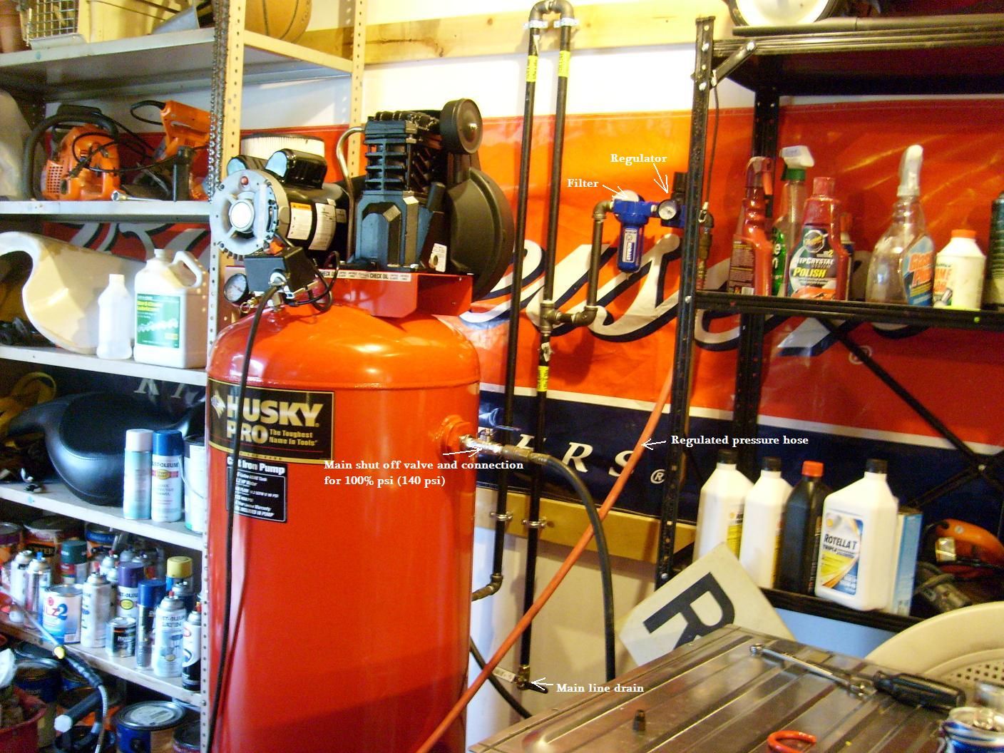

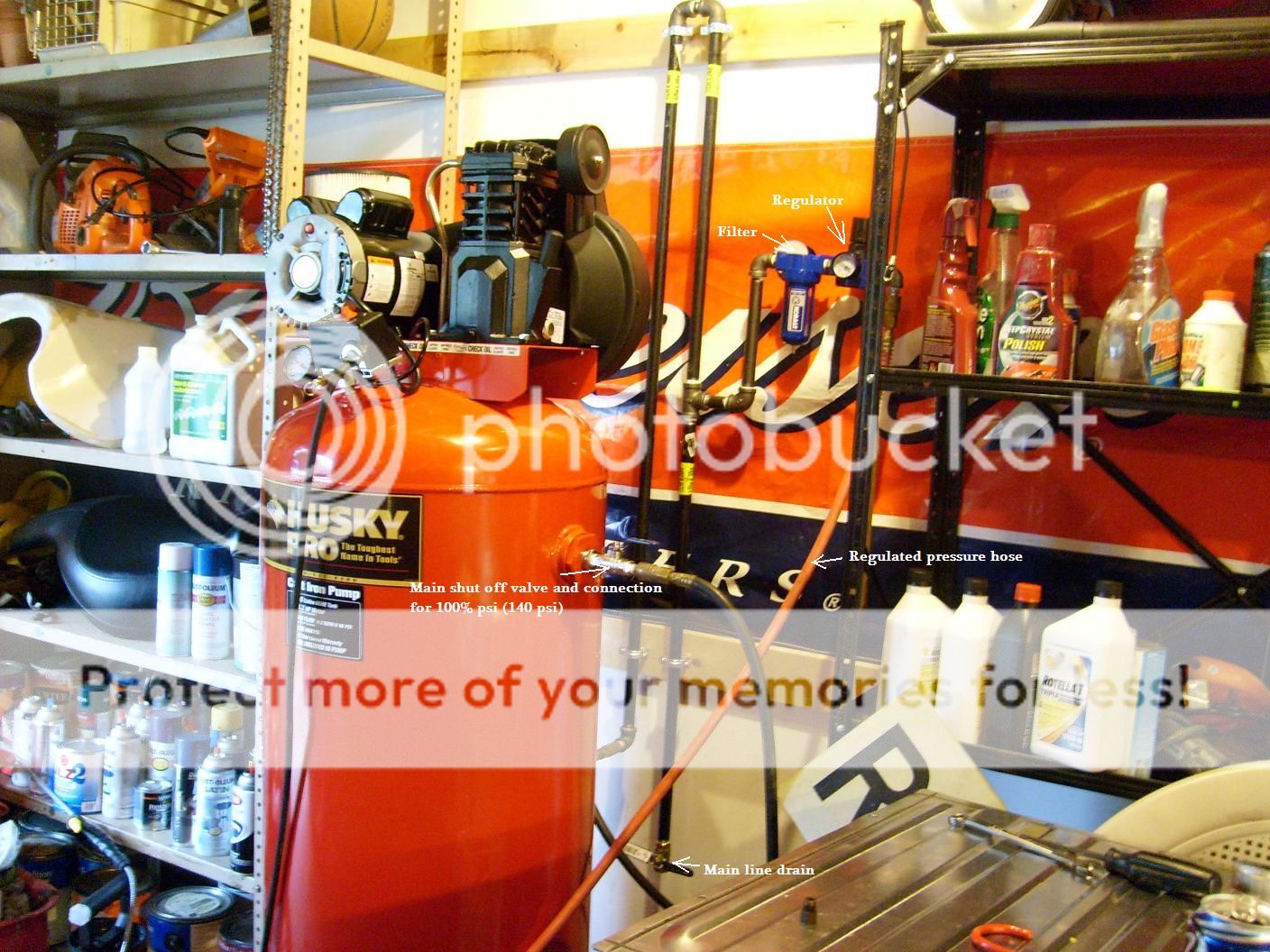

  11. predfan2001
    This is what I have now and I want more!
  12. PaulS
    PaulS Member extrordiare
    May 3, 2004
    4,858
    Seattle area
    Is that a 30 gallon 2 hp?
  13. predfan2001
    60 gallon 3.5 hp I think :hmmm:
  14. PaulS
    May 3, 2004
    4,858
    Seattle area
    It doesn't look tall enough to be a 60 gallon tank and that compressor / motor is smaller than mine.....
  15. predfan2001
    Nope it's 60 gallon for sure. I got it on sale and it kicks butt except a couple of my air tools keep it busy....but I'm picky. It's made by Campbell Hausfeld. The reserve is great.
    http://www.homedepot.com/h_d1/N-5yc...splay?langId=-1&storeId=10051&catalogId=10053
    Still working on the plumbing
