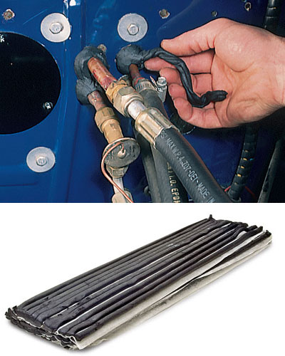

    I seal the 4 big holes using 3M body caulk strips. (picture of course is just an example of body caulk use)
    Nothing on the edges.
