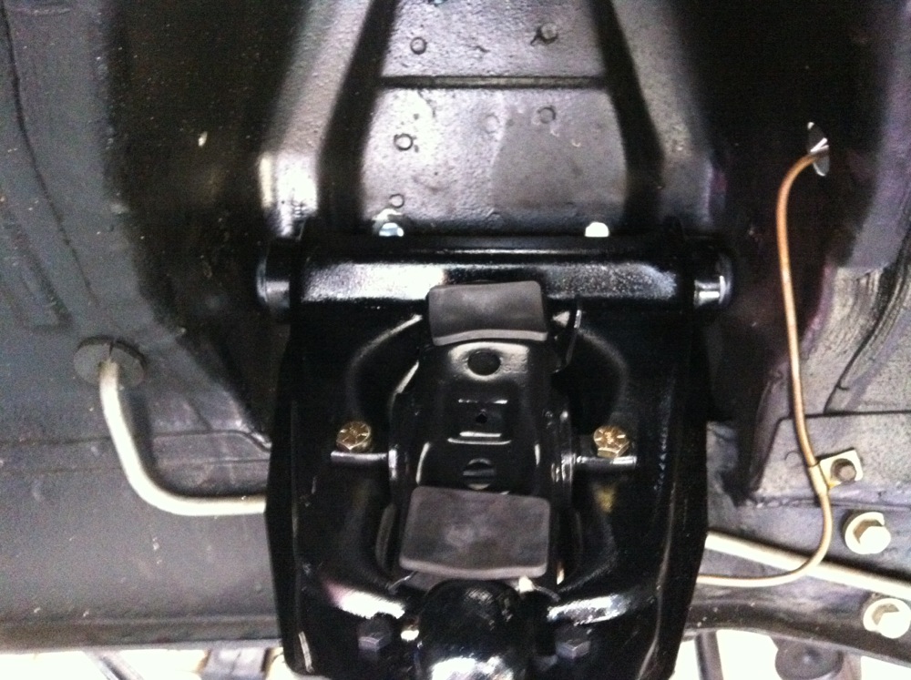

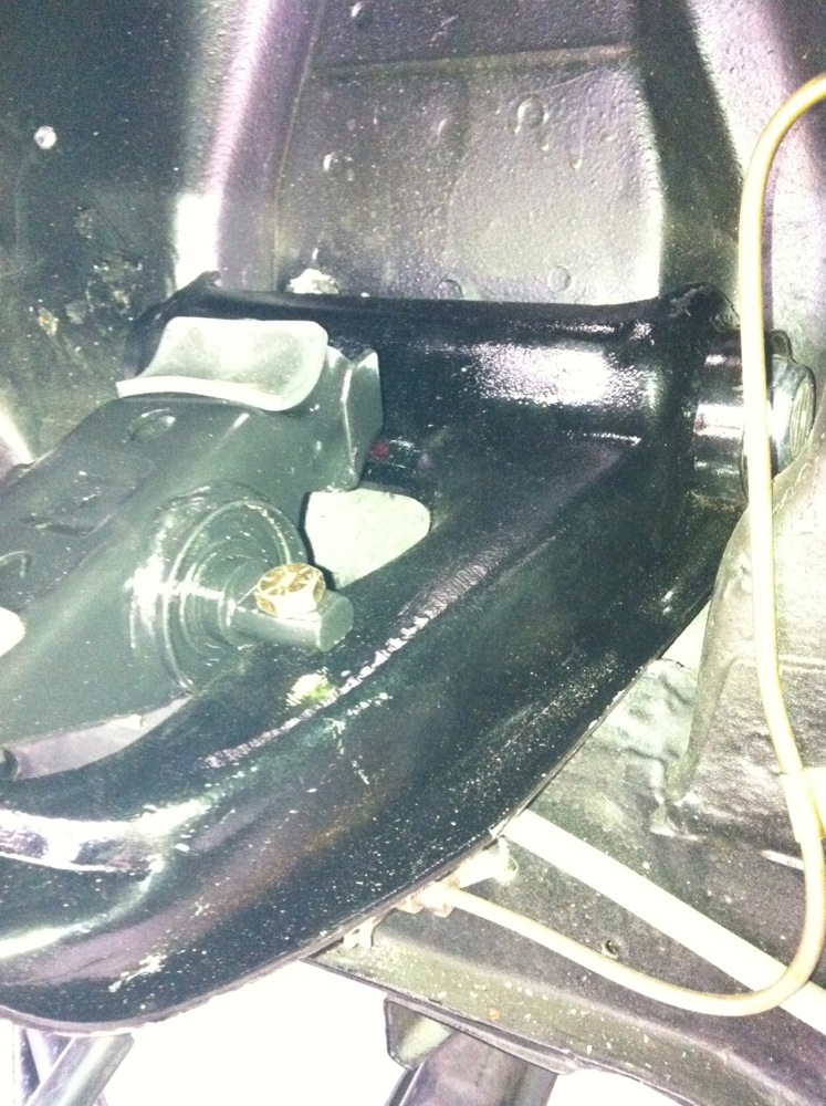

    with the engine out, i tackled some side projects - suspension mainly.
    pulled the springs, took the upper control arms out, drilled the shock towers for the arning / shelby drop:
    upper control arms fit perfectly:
    and here's why - completely rollerized with opentracker parts. bought the complete coil spring seats and modded the old control arms with their bearings:

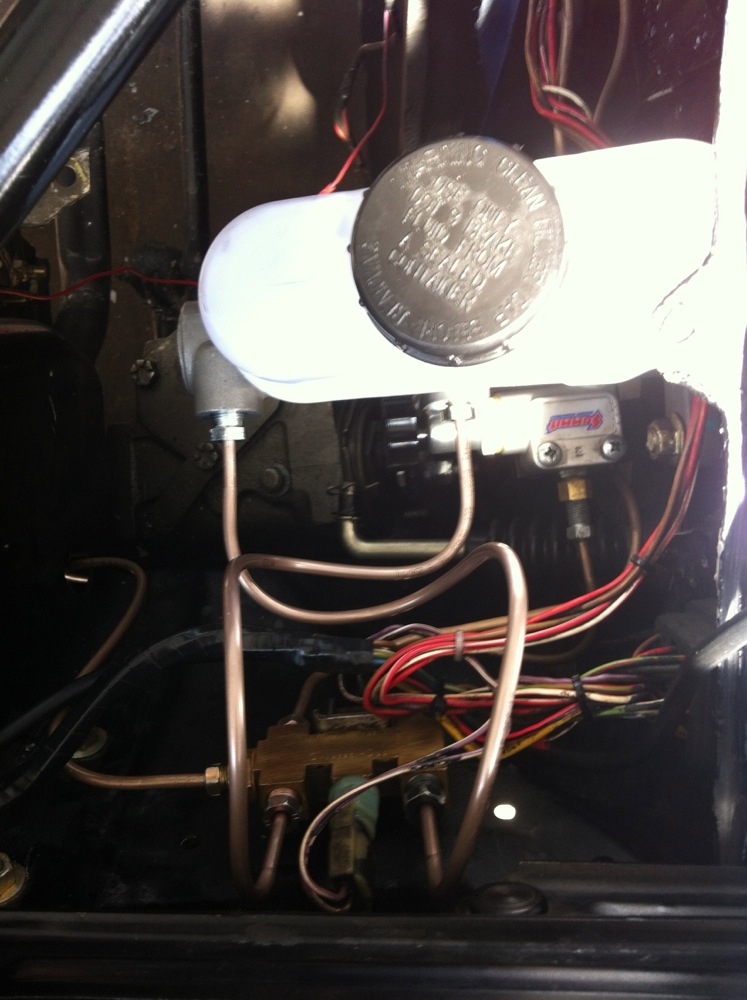

    i also replaced my brake master cylinder with a ranger unit:
    waiting for a rebuild kit for the distribution block from WCCC, then i'll bleed the brakes again.

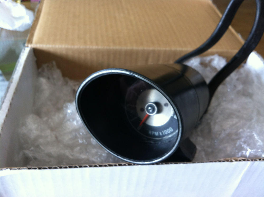

    but look what i picked up at the customs office today. big thanks to topolino!
  3. CaptainComet
    5,012
    453
    Cool tach ... is that Brazilian?

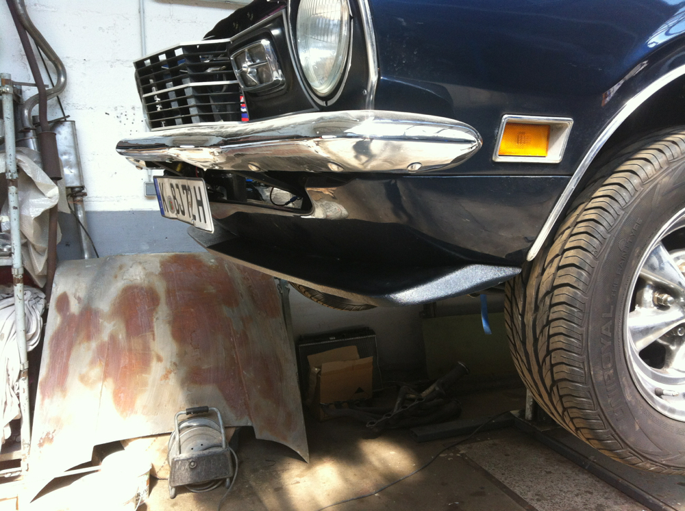

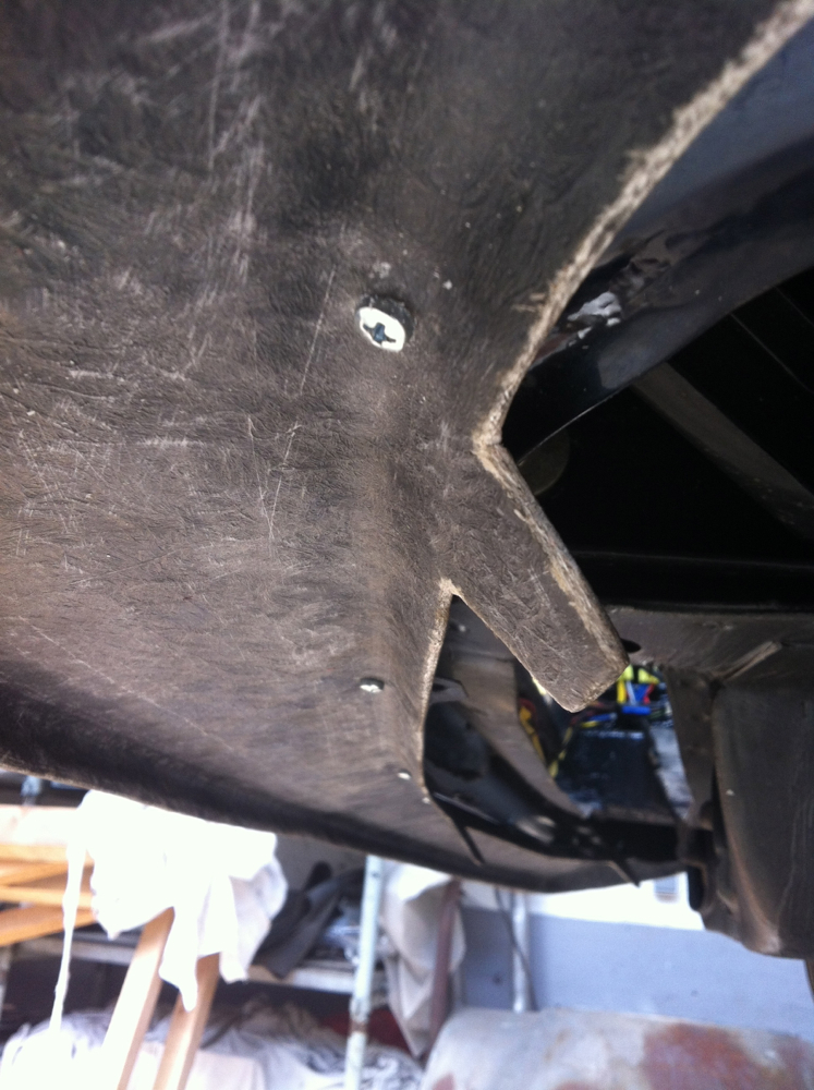

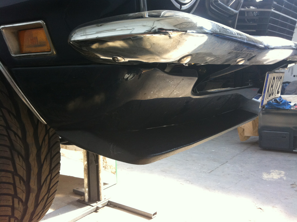

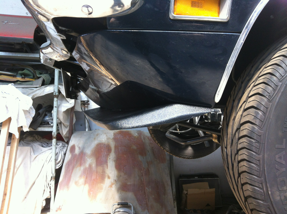

    i also mounted the front spoiler - 69/70 shelby fiberglass spoiler from mustangsunlimited:

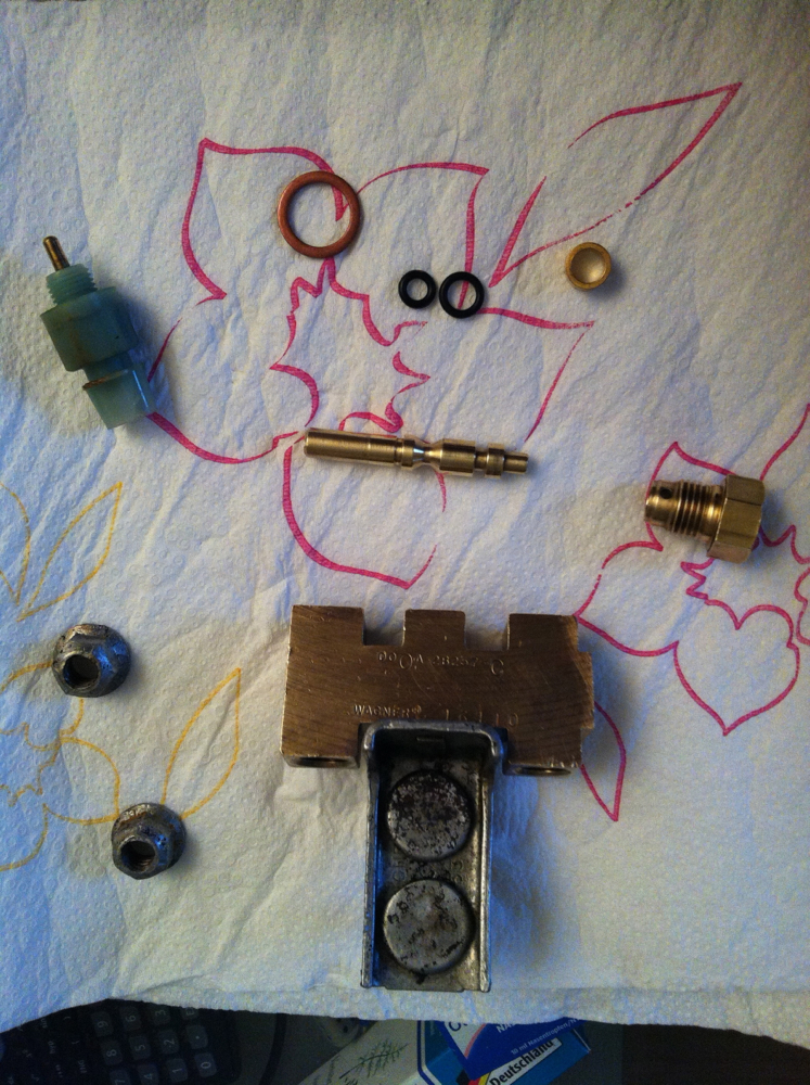

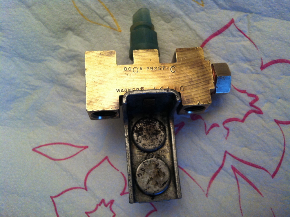

    in the meantime, i tackled the brake distribution block. got a rebuild kit from WCCC and cleaned everything in an ultrasonic bath first, then with steel wool. looks pretty good:
    now on to bleeding the brakes - would have needed to anyway, as i replaced the master cylinder.

    put the brazilian tach housing in place today. also refitted some electrical plugs:

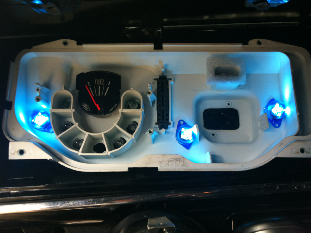

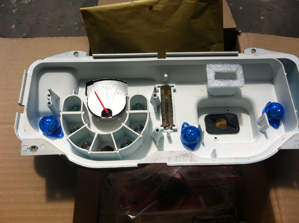

    This weekend, I tweaked my instrument cluster with a set of early mustang lenses. I wasn't happy with the light the blue leds were putting out. From my mustang i knew the lenses in combination with the leds were putting out a nice illumination.
    And a big thanks goes to Roger Moneymaker. Look what the postman delivered today!

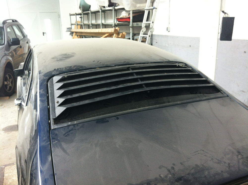

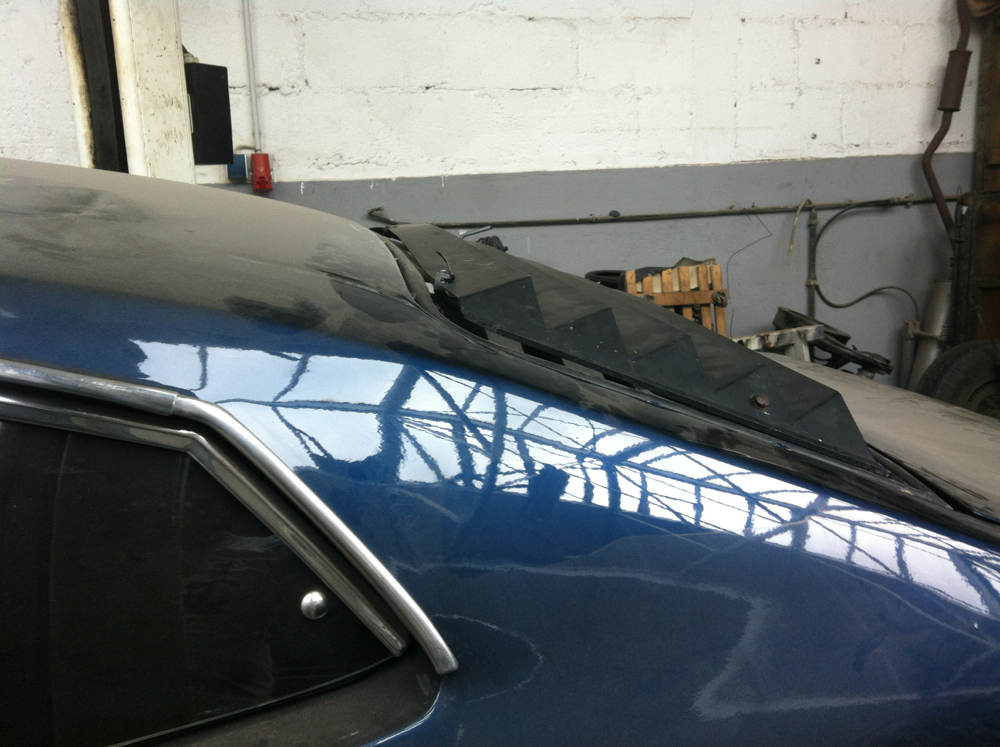

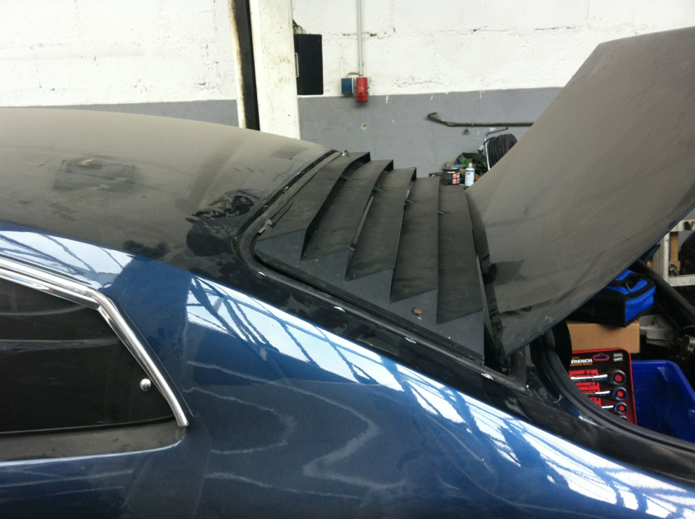

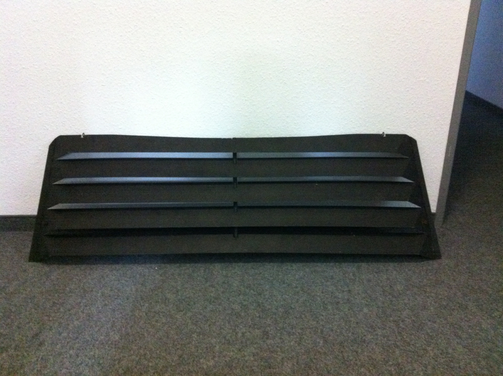

    started on fitting the rear louver today.
    here's how it sits on the car:
    that's why the bottom slat is missing:
    doesn't interfere with the roofline too much:

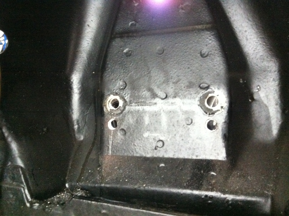

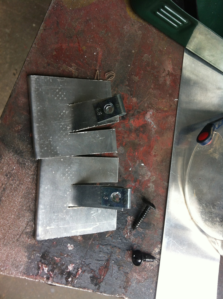

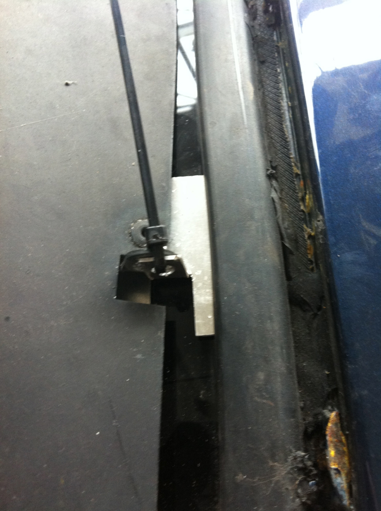

    started to fab the two top mounts out of aluminum. bent the top so it will hook on top of the glass. still have to make up something for the side/bottom mount:

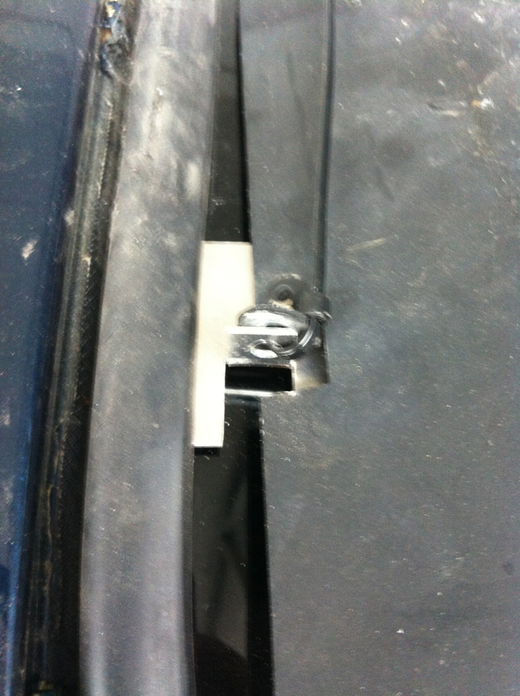

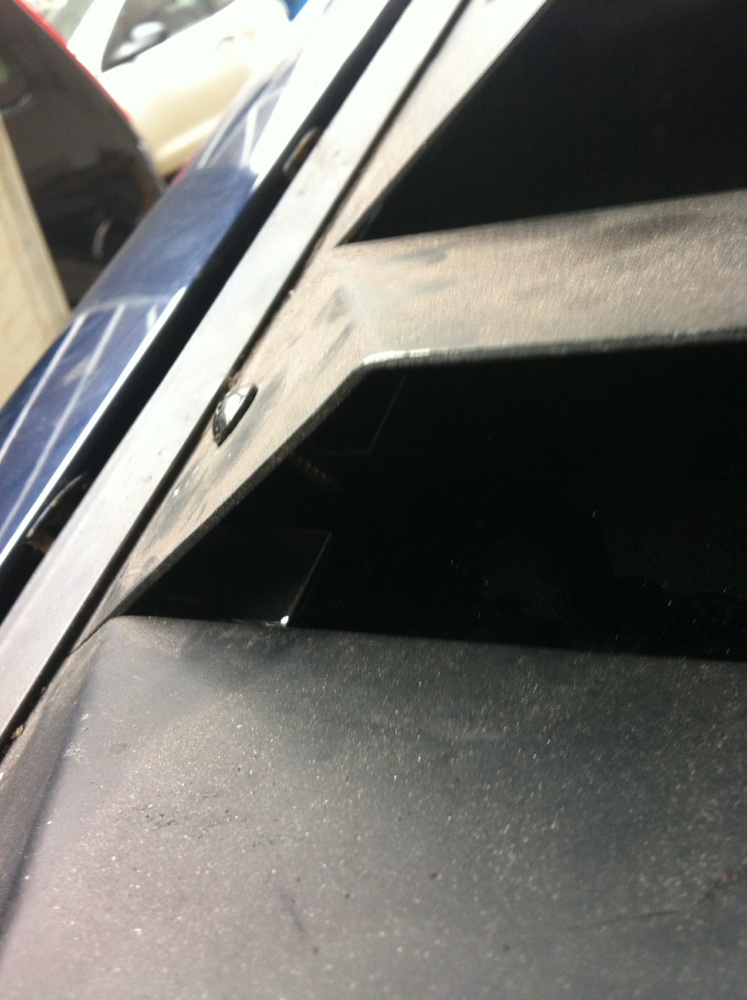

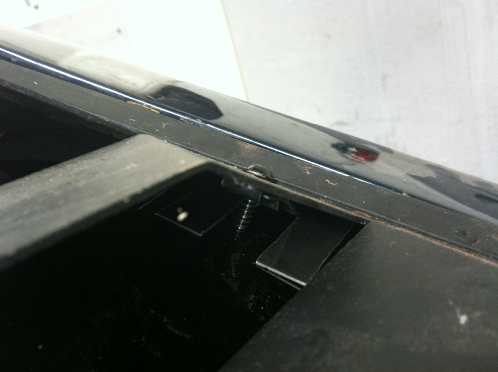

    fabricated the two bottom mounts:
    willpak refers to them as "tie downs", looks like it'll work:
