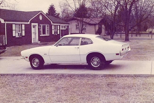

    wow, that is indeed a pretty big difference.
    in a similar thread, somebody dug out the numbers from the kansas springs website - they weren't off by much:
    http://mmb.maverick.to/showthread.php?t=80688
    bryant, can you explain the differences as you work in that field?

  12. tody
    tody Member
    Apr 12, 2008
    1,843
    229
    cologne, germany
    do you know why the numbers on the kansas springs site are that close, but the results are that different - judging from the pictures?
  13. Bryant
    i can only guess.
    i would think that the springs from the granada that were put on the maverick were not the ones that list close to the maverick specs.
    chances are the granada springs were for the most heavy duty option package that was possible for the car. they may have even been re-arched for the increased lift. then put into the maverick.

  15. Bryant
    just because they are really close in there dementions does not mean that the spring rate will be close. they a can control the spring rate by using different thickness of springs and have a different arch to them also.
    what are you trying to achieve with the rear springs on your car?
