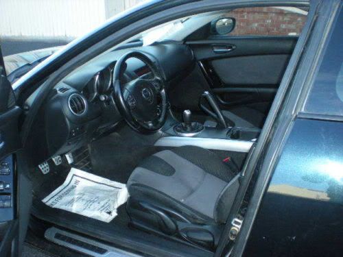

    Everything seems to point to the flooding issue.
    If this is the case with ours, I'm going to do what one person who replied in DDB's link....'
    The early models were lower compression, and had slower starters. After a flooding bout, this guy upgraded to a later model starter, installed aftermarket performance coil packs, MSD leads and hotter performance plugs, .....said it solved the flooding issue for good.
    We'll try the "de-flooding" procedure described in DDB's link this weekend, maybe pull/replace the plugs if it still won't kick.
    I really hope we can get it running,....Ever see the interior to one of these puppies? I sit in it, I gots to drive it!!
