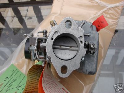

    Yes, exactly right - you need the higher mounted one since your throttle cable comes over the top of the valve cover.
    Here are a couple of pictures of an NOS Ford remanufactured one I have on my shelf. I would be willing to sell it - PM me if you need one.

    Looks like the right one for your car. See the higher linkage mount and the external high idle screw in this picture.
