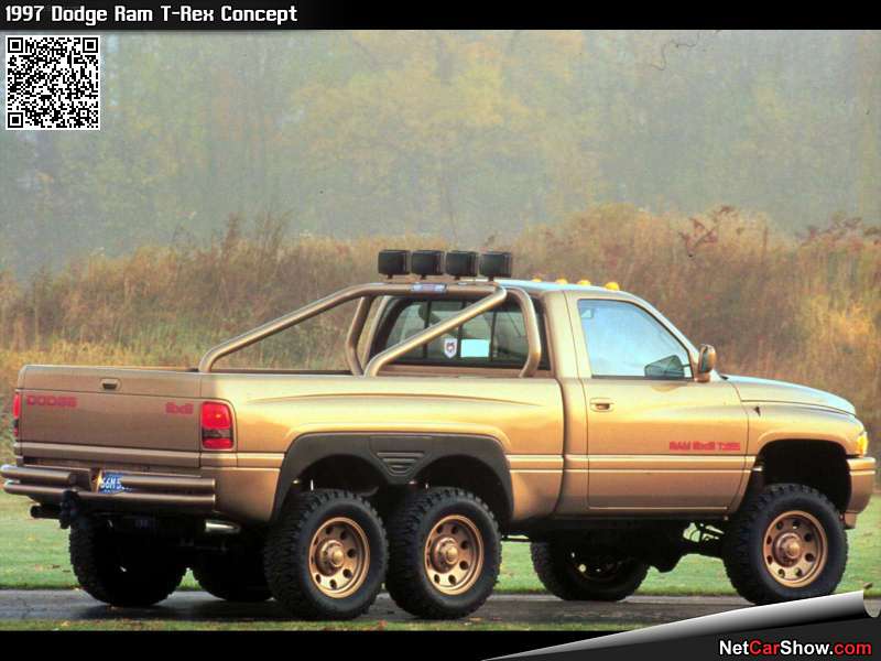

    There are a few companies that do tandem conversions around here Usually when they do them they use cut down duce and a half military axles because of the pinion locations.
    Incedentilly the 2 rigs pictured are probably the two most popular 6x6 pickups and they are made by the same guys.
    The two pickups pictured above came about because of the T-Rex concept truck that dodge made before the germans came in and ruined the company. The concept truck proved to be popular with their fanbase, but was deemed too heavy for consumers by the germans. The T-Rex concept truck achieved the 6x6 by using a dual transfer case conversion and standard rear axles.
